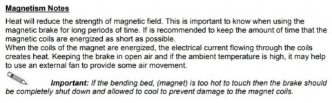

I swear these companies must just be importing this stuff with artificially tight voltage tolerances just so they can sell you an overpriced transformer. I bet in all reality it's just a 220/50hz machine they stamped "60 Hz", and would likely be 100% fine on 240/60Hz.
As the manual speaks of overheating coils (even under spec’d voltage), over voltage applied to the coils will only accelerate the heating/temperature rise resulting in more cool down time required for the user to contend with.
