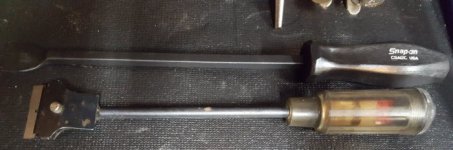

These are my usual gotos:
The Snap-on I've had a few years and there's been many of other brands similar to it I've used up over the years, but the razor scraper I've had for 30yrs or more. Pretty sure it was one of my very first tool purchases and it's somehow lasted. These will get the job done, but that Super Scraper looks like something I need to try out. I like the look of that one Eric O. is using in that video, but I don't seem to see the SS5 actually for sale anywhere though. I guess the SS1 it is then.
Here's a short vid of a guy using the SS1:
<iframe width="560" height="315" src="https://www.youtube.com/embed/LYf0y019IxA" frameborder="0" allow="autoplay; encrypted-media" allowfullscreen></iframe>
Don't know if the OP found what he was after, but I think I might have. I'll try to remember to post back here when I get my hands on one.
