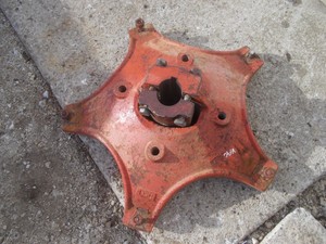

You can, if needed, cut steel with an oscillating tools. Used my Fein to cut the 1/2 bolts off my Case Vac's center clamp similar to the photo below. Difference between the picture and mine: mine was on the axle with no way of cutting it any other way (bolts on the case were originally rounded, carriage bolt type bolts).
I used the finest tooth count Fein blade that came in the kit and just took my time.
