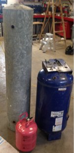

Here's a pic of the raw materials.
The tall tank doesn't end up getting used (for boiler material anyway). This is an old tank I had laying around and was going to be my boiler casing until I pulled it out of the weeds and realized it was too narrow.
The blue compressor tank will be the main body of the boiler. I picked it up from the local metal recycler for $40. It came with some bonus air pressure gauges and an air pressure regulator that I'll keep for a rainy day.
The pink steel tank is an empty helium tank. It came as part of a "party balloon kit" from Costco. My wife LOVES the fact I used it for this build instead of throwing in the garbage.

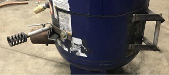

Alright. Time to move on to firebox area.
Here's a picture of the door I built:
- Hinge made using 1" angle iron, a spare piece of pipe, and a spare bolt. Bolt will be flipped later when I re-attach the door after painting.
- Latch is also 1" angle iron, notched so I can partially open the door for improved draft.
- Handle is 1" flat stock and pivots on the bolt holding it to the door. Spare piece of pipe and an old 351W valve spring are also used in construction.

And here's where we are at today!
This is a picture of the almost finished boiler ready for a test run. Lid has been finished with a handle for opening and the stovepipe opening.
I was unable to peel the stickers from the tank. I'm hoping the heat will soften the glue and I'll be able to peel them off once lit.
I'm hoping the test run will also burn off the paint so I can repaint with a high temp BBQ paint. However, the boiler will be wrapped in a layer of fireproof insulation and you won't see much of the paint job anyway.
Wish me luck on the test run today!

All cleaned up with a fresh coat of paint. Ready for install at the cabin.
It burnt really well for my test. I was worried that smoke would leak through the lid and other gaps but that only happened for a minute or so until the fire built up a little heat. After that the only smoke came out of the stack which I had extended to 8' high with a length of slip-over stovepipe.
