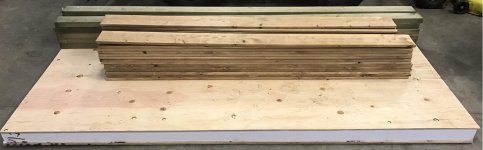

Picked up the materials for the skirting/surround today.
Couple sheets of plywood, some pressure treated 2x4's and 1x6's, and 3" sheet of foam board.
I'm going to pre-build and assemble as much as possible.
