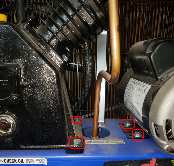

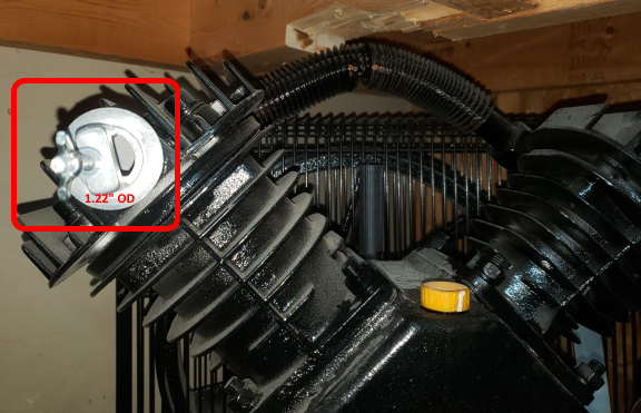

So, here is what I am thinking. I'd appreciate your input.
1) 1.25" ID vinyl tubing clamped to the intake port and run through the drywall ceiling into the attic.
jPdiiKrIRzmj8cYJmwPn6w
2) Remove (8) mounting bolts, add isolation bushings, replace bolts with longer bolts as needed.
-uDwIajoRDGLgEaBMpjPMg
3) Reconnect stock intake (in attic) - replace if further noise reduction is needed
WlUBLhXNTPeURPemIw37iw

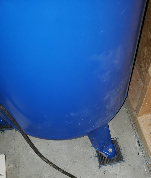

4) Photo for reference - Compressor is mounted on noise insulation squares https://www.amazon.com/dp/B00BVEMLR4/?tag=atomicindus08-20
LC00m08MSOOFgJQPLwLsMA

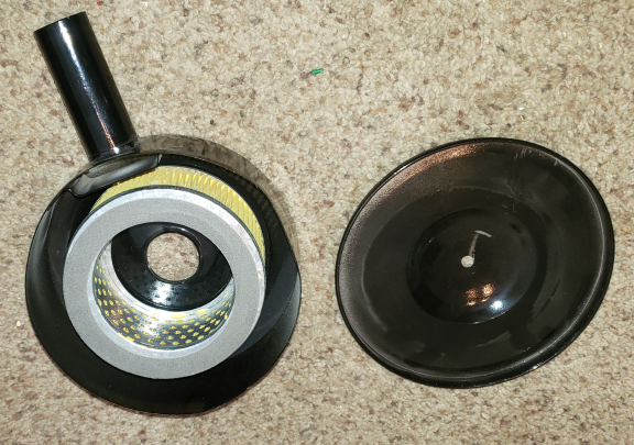

What type of compressor do you have? Can you change the air intake?
The intake is a big source of noise with most compressors. I got an 8db drop in noise levels with my belt drive 120V compressor by changing the intake filter. I described my changes a bit here
https://www.garagejournal.com/forum/showpost.php?p=8152958&postcount=6
If you search YouTube for compressor muffler there are others doing similar mods.
If this isn't quiet enough then go there extra step to add Dan enclosure. In my case it made things will into tolerable.
I have no idea what your needs are but you could also consider a second compressor. One of the "silent" compressors like the California Air Tools 5510 can do a lot of light work and is no louder than an idling car. Use your big compressor when really needed and the CAT the rest of the time. Might be cheaper than doing a fancy enclosure.
Still, start with the air intake.

Your air intake looks exactly like what came on the compressor. Honestly, this compressor is not unbearably loud. I got rid of the cheap Kobalt regulator which leaked, so now it should not kick on every 15 minutes like it did before. I just like to tweak things, so I will see what I can do to quiet it down further.
Thank you for your reply!

Any rubber pads need to be on both sides of the mount to totally isolate the vibration/sound transmission, not just between the parts. The bolt/nut will transmit the noise also. Think of the part sandwiched in rubber(like shock absorber mounts or engine mounts). For example, pic #4 there should be rubber between the nut/washer combo and the top of the tank foot as well as under the foot.

These pictures didn't load when I posted yesterday.
With that setup you can get an idea how much simple intake mods will help by plugging the intake with your hand. That will be about as good as any intake mod could hope to be.
The rubber hose on the inlet of the filter housing is very cheap and does help quite a bit. Some people have done things like send that hose into a car muffler or a box with sound absorbing material that acts like a muffler. I'm not sure how much that helps but it can't hurt. In my car just the rubber hose did a lot. I'm not a huge fan of pulling air in from the attic because it will be very hot in the summer. It's better to draw in cooler air.
After that you are dealing with the mechanical noise and the tank acting like a bell. I've heard of people putting sound deadening material on the tank. The rubber pump mounts would help but I would worry about how that could affect the belt alignment and that intake tube would have to be redone with a loop for stress relief.

If you add rubber vibration isolators to the compressor mount, I think you need a more flexible air line connection to tank compared to the hard copper line.
Not sure the rubber vibration isolators for the motor will help much given the belt. I can’t imagine a down side of these as a belt and suspenders approach though.
Good points. I think I will hold off on the isolation mounts for the compressor and motor until I try some of the other mods. Placincg the rubber mounts on both sides of the feet had not occurred to me. That is easily resolved.
I hope you make the first decade. That compressor may become the deal breaker if you make it the most important thing..
I'll try that, thanks!
