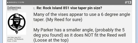

Unfortunately it’s missing the tapered steel pin for the swivel jaw, and I was wondering if anyone knew of a source where I could find one, or anyone has made these on a lathe?

Not sure where to get one, but it would be an easy thing to make on a lathe with a taper attachment, and not hard to make on a lathe without one. Were those hardened? I've seen them in videos, but never seen one in person.

Thank you for your reply Dave. I’ll plan on making one then, and like you said it shouldn’t be too much of an issue. I’ll take a couple measurements with a caliper of the top and bottom diameter of the hole so I’ll know the correct taper.
By chance would anyone be kind enough to take a few pictures and measurements of their pin and post them up?

According to another thread, your vise might need a 6 degree pin. Maybe a place to start anyway.
