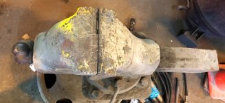

Thanks. I too am looking forward to having it done and useful. Though I plan to build a stout bench for it which will take a little while yet. Found a 1.75" thick steel plate about 2'x4', close to 500 lb. It'll have 2" square tube legs angled out a little for a better foot print in the 2' dimension. Also will have a couple pieces of 2" receiver tube under the top for mounting other tools like small shear, hole punch, smaller vise and so on.
Test fit the new split nut this evening. Needed to file the break just a little bit, works great still. It did bend/deform just the slightest bit before breaking, another reason I should have frozen it prior to breaking.
Here it is in my little old vice, an Athol I think, have to check. My Dad gave it to me when I was about 13 and mounted it on a workbench in an old shed, it was the greatest tool ever back then, I used it for all sorts of things for years. Just recently I set it up in my own shop with a stand made from a truck axle shaft and brake drum, handy for many things and portable but not sturdy enough sometimes. It'll be nice to have a good solid bench vise again.
G
Grigg
Jul 31, 2010
268
Lexington, VA
Yes, bearing in there too, turns real smooth.
Not enough room for the spanner, I can see why that split nut could be tricky to remove if rusty.

Waiting on warm weather to paint.
I've been thinking about finishing it though, does that count as progress?
What's the perfered grease or oil for the main screw? What did or does Reed use?
EOC_Jason
Jun 25, 2012
11,388
Bentonville, AR
I usually just use bearing grease on the screw and also in the front hole where the handle makes contact against the dynamic face.
I'm sure you could use a more fluid type oil, like motor oil or way lube, but then you would have to always be lubing it.

I used some thick Lucas oil stabilizer stuff on the thrust bearing and screw for now. Used red grease on the split nut. Anti-seize on all threads and the body of the center pivot screw. For the main slide I set it on the wood stove for a while and melted some paraffin into the machined/unpainted surfaces, I think that'll lubricate without attracting dust and grit as well as protect from rust in the long run.
It's all done except for a couple pins for the pipe jaws.

It actually wasn't that hard. I let NAPA do the heavy cleaning in the hot tank. I quickly wire brushed any remaining rust, remove burs and such with a file, wipe with thinner and prime and paint. Didn't spend any time polishing the handles and such as some folks do, I just wanted a clean functioning vise.
The missing part took a little effort but as for the rest of it anyone looking to restore a vise could follow the same steps and have a nice looking vice. Using the hot tank at NAPA was well worth the very few $ in all the time and aggravation saved not cleaning and stripping paint.

I've been using it a little and it is a very nice vise, glad to have it and have it all fixed up. The thrust bearing on the lead screw is quite nice, it's real smooth and precise clamping something, and adjusted to essentially no backlash so it opens crisply too just as soon as the handle is turned.
I did eventually make a new 9/16" pin for the pipe jaw so it's all done now.
I do still want to order a set of new jaw inserts for it, and make a better table.

GRIGG: ...would you do anything different if you were making another split nut?
I scrounged a piece of cast iron from an old diesel piston, you could purchase some cast iron bar stock to start with. Cast iron because the nut needs to be broken in half later, cast iron breaks instead of bending
http://www.dura-bar.com/products/gray-iron/index.cfm
The threads are 3"-12, I machined the pitch diameter to the small side of the allowed tolerance to be sure it'd fit on the first go.
The rest of the dimensions you can measure what you have and make it to fit.
I didn't do this, but to do it again I'd first chill the nut in liquid nitrogen. Then quickly split it having previously made two passing wedges to fit in the ID of the nut and when slipped past each other would expand to break the nut. Or, might could clamp half the frozen nut in a vice with smooth flat jaws and whack the other half with a dead blow hammer, might snap off clean, I didn't try this.
Doing it at room temperature in the press caused some deformation at the break and required a little filing to get it to fit and screw in again, not ideal.
I used a needle thrust bearing part number FNTKF-4872, not original but a nice upgrade. Needs a washer (just thinner than the bearing) made to adapt the the ID of the bearing to the screw diameter which keeps new bearing centered.
