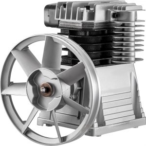

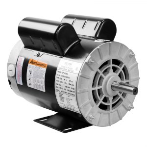

Also stumbled on this old thread, wondering someone could tell me how well this pump from vevor will pair with my motor on my existing air compressor
Appreciate everyone’s input on this thread. It’s been helpful
5ubtle
Jun 15, 2016
395
Spartanburg, SC
@thewopperchop
Welcome to the forum. The pump spec states "Power 2.2 kw" and "Capacity 12 CFM"
2.2kw = 3hp. 12CFM (about 4CFM per hp) suggests that the pump requires a motor with 3hp output.
Your motor input power is 230V * 7.5A = 1.7 kw (2.3hp). Your motor output power is lower; probably about 1.5hp (1.1kw).
Your motor is too small.

Would it make a difference running it 115 versus 230? I’m judging by your math I guessing it would half the hp? So either I would need a different pump or a new motor, also why would the motor say 3hp on it if the math says 1.5😅 would you do ma a favour and suggest a new motor
mike93lx
Dec 9, 2013
37,718
Richmond, VA
The HP rating is a lie. Voltage doesn't change power consumption... Cutting voltage in half just doubles the current draw

So this motor that is 230*15 would be double the hp ( so a little bit more then needed) would work better then my old motor with that new pump I linked earlier
The Vevor motor that you linked would be a good match to that Vevor compressor pump. Your next step will be to ensure that the pulleys are correct to get the right pump rpm.
