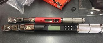

I have the old and new Control Techs, new one is just a bit faster to start up.
The have a new micro torque wrench. 1-20 ft-lb the same as the smallest C-tech 1/4" and same accuracy.
