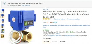

Got my valve from Rapidair, it has 230psi on the specs sticker on it, it works well. I did order a cheaper version to try at work that runs on 9-24v DC and seems to be rated about 230psi as well, but havent received it yet.
https://www.amazon.com/gp/product/B06X9LWXMW/?tag=atomicindus08-20
I actually ended up buying the 1/2" valve from Amazon that you linked to. So far it works great (time will tell) and I like using low voltage since my nearest outlet was about 12' away. I dug up an old 24v wall wart transformer (US Robotics - how long have I had that) and just spliced in a piece of wire to reach.
This particular switch (2 wire with auto return) will automatically close when the power is cut off - I believe it uses an internal capacitor to store the energy versus some other motorized ball valves that use a spring type mechanism to close the valve.
I also like the motorized ball valve versus the type that uses a solenoid because a solenoid has to always be energized to stay open (or closed, depending on the valve) and I believe the ball valve is less restrictive. The motorized ball valve takes 3 or 4 seconds to fully open or close which I consider to be a 'soft start' :)
So I am using a Z-Wave controlled outlet and with my Alexa Dot out in the garage, all I have to do is tell Alexa to turn the air compressor on or off. I also have an event set to run to turn it off every night just in case I forget
Well worth the $31 and I really like this solution better than using a contactor and having to rewire everything. Since the air pressure is being shut off and not the power to the compressor, when you want to use the compressor, you don't have to wait until it comes up to pressure since it is already ready to go

Cue - keep us posted. The Rapidair one is 3/4”. The one from Amazon you linked to is 1/2”
Yes, My stuff is 1/2" but the only one Rapidair has is 3/4" so I had to use adapters on it so the 1/2" one would have been better to start with but I didnt know they had them on Amazon until after ordering the one from Rapidair.
A soft start valve is a much better solution in my opinion. It slowly pressurizes until 1/2 header pressure and then opens fully. This prevents slamming the system with full pressure.
These valves are also "soft start", they slowly open to allow the pressure to come up slowly instead of all at once. My Rapidair one takes about 10 seconds to fully open.
