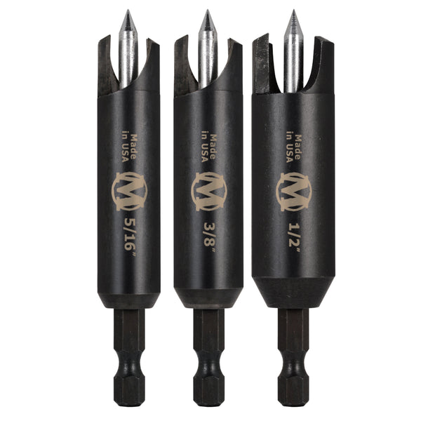

If you have an extra piece of mahogany, you can make proper top plugs to fill wood holes with these centering plug cutters that are available from Lowes.
I presume the plug cutters are rebranded from Montana brand, snd maybe also available under some other brands.
If you ho this route, you can screw up the upper layer of wood around the broken screw, to try to remove the rest of the screw with thin nose vise grigs or some sort of screw removal pliers, and then drill out the proper sized hole to fix the gouged section of wood, and infill with a plug made from the right type of wood, and having the right type of grain direction.
How's that work, the center pin retractable?
I have the Montana branded set (https://www.montanabrandtools.com/products/3pc-plug-cutters) also available in places such as Woodcraft, tractor supply, and Rockler. I bought my set direct. I also have some from a different maker but for this I use the Montana brand.

Agree with those above recommending a plug. It will be stronger than a dowel because the grain will run transversely instead of inline with the new screw. I've repaired even some fine furniture with them. I use these cutters which make a slightly tapered plug. Apply wood glue and a mallet and then chisel off the protuberance after it dries. Best even to direct the grain of the plug like the door but not critical for this. IMG_1234.jpeg
