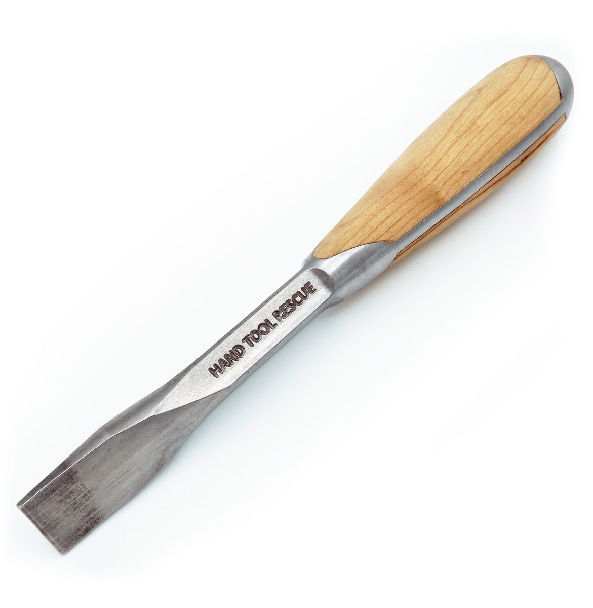

Is there a special tool for removing over-sized slotted fasteners that are not designed for regular straight-blade screwdrivers?
As an example, beow is a pic of the pop-up tub drain plugs used in my bathrooms, but I seem to run across other applications on occasion. Even my largest straight-blade screwdriver (5/16") easily cams out and boogers up the soft metal, even with lots of down force applied.
I don't think a coin driver will work well since they have a radius on the tip. I'd rather not have to cobble something up if there is tool that will work. I know, first-world problem, move on with life, etc, etc!!!
Appreciate any input!

handheld impact driver bit - the largest flathead one. still too small?

1/4" bit driver set, They usually have a flat blade type that fits those "shallow" slots pretty good.
These are the hollow ground type im talking about, there not on a taper like a regular screwdriver tip.

Thanks for the replies! A drag link socket would be the cat's meow, but a quick Amazon search shows them to be surprisingly expensive, especially for this goofy one-off use. The suggestion for an impact driver bit is looking pretty good. I see you can get bit sets that go up to 1/2" or so, and the flat blades appear to be hollow ground. So, that looks like a promising avenue.

Harbor freight sells a 6 piece over size screwdriver bit socket set ( 1/2 inch drive ) 3 slotted and 3 phillips. I have them and they work great. 14.00 , lifetime warranty.

I have a bunch of old brace screwdriver bits that are really wide for jobs like this. Not strong enough for a vise swivel nut, which needs a drag link, but otherwise works See the left side of this image, just to the right of the drill index. I have even wider ones elsewhere.

You can get larger screwdrivers, but most brands cap out at 3/8". I believe Klein and Felo offer a 1/2" driver.
Otherwise, a drag link socket might be the way to go.

I have one of these for use with my photography/videography gear - lots of wide slotted fasteners on tripod plates.
I wish they had these when I was a First Assistant Cameraman. It always bugged me that the widest screwdriver I could find would ****** the slot in the brass tripod screw. I would imagine you'd make a little lanyard and clip this onto your belt or AKS bag.

Great suggestions! As usual, GJ doesn't disappoint, and I learned some things (never heard of a faucet driver or hurricane bit before). While the fastener I started this thread about looks very large to me, after I measured it, it is only 3/4" in diameter, and the slot is about 1/16" wide and 1/32"+ deep. Its brass and very soft, but this is a low-torque application. Looks like a lot of the suggested tools have tips that are too thick, or at least it would be so close that I don't want to risk ordering a tool that may or may not fit.
In the meantime, I looked through all my 1/4" hex shank bits hoping to find one bigger than my 5/16" screwdriver. The largest I had was also 5/16" but it fit the slot much better. Weird. So I inspected the screwdriver tip and found that it is not perpendicular to the sides, it has a slight chamfer (almost looks like a chisel with a steep face), so it doesn't engage the shallow slot properly and cams out easily. This is an oh-so-common Craftsman acetate handle screwdriver from the '90's and has been used as a pry bar for 99.9% of its life. Tip wasn't damaged, just misshapen. So first order of business is to file the tip down and see if that does the trick. I also plan to get some larger bits for future use. I think 3/8" will do it, but I'd like to have additional larger options.
