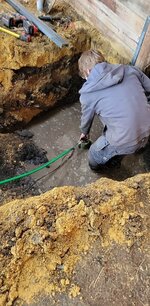

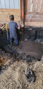

I recently fixed 5 poles in my shed. I dug down to the bottom of the poles found huge boulders under them put 3 inch channel iron on both sides bored a hole through at the top and bottom and put in 5/8 all tread and lag bolts should last longer than the shed. The worst part was my ground wayer was high had to pump it out and let it dryreceived_229303803111537.jpeg
