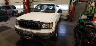

I have an ‘08 Tacoma with 102K mi. It is going to my Grandson in a couple months as he begins driving. On the punch list for the truck are replacement headlights. I want full replacement fixtures. I have de-glazed the lenses a couple times and it is time to replace. A quick look at fixtures and there are all kinds of them with different lighting capabilities. What kind of bulbs do you suggest. I want good light without ******* off on coming drivers. Much obliged for suggestions.

How bad are they really? I've replaced housings with aftermarket and they just weren't the same.
I'd get new OEM if they exist or polish them real good one more time and clear coat them with UV spray.

Find something as close to OEM as possible. I got some decent repops off rock auto a while back.
To avoid glare don't mix lighting technologies. HID or LED retrofit bulbs can be hit or miss on performance and glare. Safe bet is halogen bulbs in halogen housings. I have done almost all the different combinations over the years, some work great but finding that one can be difficult.
