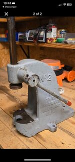

Hello Good People,
I have a few handles I’d like to swap out, Press/Vise/Drill Press. I’m wondering for the ends would I be better served with a lever or ball knob and would it be a stronger connection with the ball knob being male or female?IMG_5681.jpeg
This little handle won’t cut it. And figured while I’m at it I might as well clean them all up.
I have some 4140 rod, not sure what the best way to go would be but am open to any suggestions.
Thanks

This is the handle it came with, my brother in law turned me a a solid handle from his stock.
So I’ll have a good amount of leverage, I like the idea of heating one and cooling the other I never thought of that. I have been looking for a day or so at different types of knobs, Ball, lever, threaded (internal/external), fixed.
Should I heat treat it?
Thanks for the insight gentleman. 🙏

At this point it’s more about getting the most from this little press while not abusing it. I used it a little this afternoon making some hinges and plan to make some tooling for it tomorrow to bend sheet metal. All light duty stuff.
I just want to take advantage of all of its limited capabilities.

-Well......shucks. I've just had a look at your press and didn't realize that it's a round ram, unlike almost all of the manual ones I've seen for the last few decades (square ram). Yours has undeniable vintage appeal but will be more complex/difficult to create a gib for it. I understand that there's what you consider excessive movement between the ram and the housing. With a square ram it's a simple matter of dropping in an adjustable plate to reduce/remove excess play. Many of the square ram presses even have this feature built-in already. The way I see it, now that I looked, your options seem to be:
1) Buy another press with a square ram. A brand new 2 ton model is about $200 so a used one in good condition should be under $100
2) All your tooling will need to be guided with the tooling/die locating the work. Everything is contained in the die so it doesn't matter if the ram moves around or not. Guided tooling will be more complex and more expensive (maybe not very much) but you just flop the tooling in the press and you're ready to go. You wouldn't have to do anything to your existing press.
3) Create a gib for the press you have. That will be more involved/expensive with limited benefit. The gib for a round ram may contain movement in the X and Y plane but there's still rotation of the ram to consider. Either of the above two options would address movement in all three degrees of freedom.

My initial thought was to make a quick release or chuck to allow for quick changes of tooling. However, I do have a good amount of steel that could be easily welded together to allow for more secure pressing.
Yes, this press is old. Probably over 100, I’d guess the round ram idea came from Greenerd. But also that they have a design identical to this for a straightening press with a round ram and wheel with a ratcheting compound lever mechanism mounted on top. The throat is very shallow, while the cast iron on the back is overbuilt. I believe this may have been the same casting for the other press adapted to something more universal.
Dana changed hands, I can’t recall what’s in there now. I worked on Zug island as a Laborer back in the early 2000’s, it will never be repurposed into luxury condos.
I have the tail bolted to an existing hole in my benchtop, which is temporary but sufficient. I’ve been thinking about the press table, and how a micro fixturing table would be ideal.

Now, the handle still needs to make whatever rotation you need to get there, but this allows you to get it into a nice working position for your actual pressing operation.
On my big long stroke FAMCO (Art, the Arbor Press), I replaced the handle with a machined out socket and use a 3/4" drive ratchet. That original sliding rod was quite large and it pinched me hard, twice, before I ever even started the restoration work on it. It had to go.
I also added sensitive handwheel on the opposing side for positioning and put in a friction lock on the shaft to lock it from moving.
Just other ideas.
Before and after pics for reference

Fantastic job! I like the ratchet idea and the ram relief, using my press the past few days I definitely see the value in both.
rustyzman
May 7, 2015
772
Chicagoland
I didn't do the tooth removal on mine, because the ratchet serves to give me what I need. I love that arbor press, it is so handy. Only about 3 tons force, but almost two foot stroke.
I did have a broken off tooth on the pinion gear that I did not realize when I bought it. It was pretty seized up, as it had been living either outside or close to it for a long time. So I did have to make a new tooth for the pinion, machine out the broken one and pin the new one in place. In effect, it had a tooth relieved when I got it, but it was on the wrong side of the equation!
Plus the gib plates were missing, so the screws were just gouging the heck out of the ram... Sad how people treat stuff.
