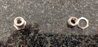

  • Supermicro rack server chassis have two fasteners on each side (I believe they are called "self-clinching standoff nuts") and these threaded fasteners are used to connect the server chassis to the "rack ear" (L Shaped bracket) which has a handle on it. That handle is used to pull the server out of the server rack, but also the rack ear allows the server to be secured to the server rack with a rack nut / bolt. (see attachment - 1 Rack Ear Front.jpg)
  • On the inside of the chassis, this faster has a hex head and with the fastener removed, there is a hex shaped impression (possibly because the fastener was pressed in with quite some force?). (see attachment - 2 Chassis Interior.jpg)
  • On the outside of the chassis there is a standoff which the rack ear screws into. I've provided a picture of what the exterior looks like, but without the fastener. (see attachment - 3 Chassis Exterior.jpg)
As to the issue, unfortunately the 4 fasteners are broken and need to be replaced
  • I contacted the manufacturer and they wouldn't provide any information as to the type of fastener and said it is a non-user replaceable part.
  • Images of the fastener are provided and it doesn't surprise me that they broke as they look quite feeble to my untrained eye.
  • Note, where you see a fastener that looks like it is intact (hex head + threaded standoff) that is because I pressed it together in order to provide a picture, but I don’t think that is a solution of course. (see attachment - 4 Fastener 1.jpg) (see attachment - 5 Fastener 2.jpg)
To my questions
  • Would anyone be kind enough to identify a like-kind replacement for what I believe is a "self-clinching standoff nut" and where I may procure? I don't need to replace the screws which insert, but unfortunately I don't know what size they are, whether metric or SAE, but I do know they are smaller than M4.

I'm finding it hard to follow exactly. How about epoxying a standard hex nut of appropriate size into the place its supposed to go and then using judicious torque.

Rivnut. They work great and should solve your problem.
http://www.swfastener.com/pdf/RIVNUT-TheOriginalRivnut.pdf
I came across these when I was spending hours trying to solve the issue myself (thanks much for the reply!).
Ideally I believe I need a hex head (page 22), to fit into the existing hex indentation, but don't see this as an option in the document (unless I missed it). Since it is called out on the "Design Options" page, I'm not sure if this precise solution (with hex head) would be economical?

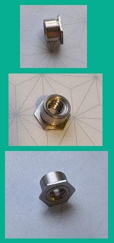

Take a look around Mcmaster-Carr
Search for self-clinching nut. PEM is a company that makes all kinds of self-clinching nuts, stand-offs, studs, etc. Looking at their website may help you too as they are one of the major players in making self-clinching fasteners.
Below could be what you need.

Another type is a "Nutsert but not a spacer type,it can be hand installed with the tooling, www,browntool.com may have this hand installation tool.

Still think a low profile flange rivet nut (rivnut) would do the trick.
https://www.mcmaster.com/nut-inserts/rivet-nuts/steel-low-profile-rivet-nuts-7/
or similar
My recommendation for @bsdummy - being experienced in its use - but not more precise matters requiring skill:
proxy-image
A poor joke of course.
Seems you could spec the round flange to fit within the hex emboss? or even have it overlap with the low profile flange listed above?
I favor this one, with a direct replacement of the hex head, possibly requiring a few more feet lbs of force to defeat? However, I think @bsdummy has a far more "forgiving" situation than I did - where I was already placing extra duress on the chassis that it wouldn't otherwise be subjected to.

I know this is a 2018 thread but this was google's best result and cmandp/svtkobra7 suggestion of mcmaster flush mount press fit nuts was close enough to repair a SC847 chassis. Specifically 94674A515 nuts and 97519A096 rivets. On the SC847, I needed to drill a few rivets and remove the drive cages for access.
94674A515 is nearly identical to a factory installed Supermicro nut but has a groove cut in it.
The old holes were out of shape, I roughed them into shape with pliars then some hammer and dolly work. Still far from perfect but close enough to rivet the drive cage back in. The fix is ugly zoomed in on camera but short of having a press that could fit in between the sheet metal sides of the chassis and a die or spending way too much on the correct installation tool it's good enough and out of sight.

@DigitalPackrat did you buy the $500+ tool to insert these? Your solution looks like it would probably work for me. Attached is a picture of my damage. Curious to know if you found an aftermarket press cheaper and if you have insight into what i might need to do to get this fixed.
I’ll let you know how my adventure goes, I ordered the parts he listed to fix a chassis I bought with a missing handle that I didn’t realize at the time was missing the nut inserts.
I didn’t use a press, I just lined the nut up and thwacked it with a hammer. Once they get past they are a little loose. I put a piece of scotch tape on the back to hold it in and I put a spot of super glue on it to hold it.
In a couple days my new handle will arrive and I’ll reassemble it all and rivet it all together and I’ll come back and let you know if it all worked.
