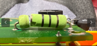

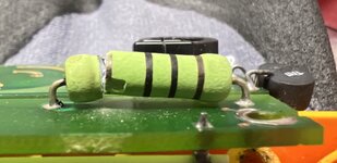

I can't figure what resistor to buy to replace this one. It's from a Fluke T5-1000. It looks like there are 3 black bands and 1 brown band.

Edited: don't do math tired, or you imagine more colors. 10 ohm, not 100.
If it is Brown-Black-Black, it is a 100ohm 10ohm resistor. The last band by the crack is the tolerance (looks gold to me)
Three blacks and a Brown doesn't make sense. Either it is using Brown for the tolerance (1%), but Black-black-black is a meaningless color combination (00x10^0), or it is 100ohms 10ohms, but black doesn't denote a tolerance spec.
Most modern resistors are 5 band, not 4 band. Sure you aren't missing a color?
Can you find a schematic?

The second picture looks like Brown-Black-Black-Gold but its hard to tell for certain. I also see what looks like a paint "dot" on the left hand side in the first picture ? Are you sure it is a resistor ? I have seen some strangely marked diodes in some automotive applications.
I would call Fluke and see if maybe they will tell you or at least maybe send you a schematic ?

That isn't how the third multiplier band works(Check your math on 10^0). Brown black black is 10ohm. I agree that the last band looks gold. OP, can you confirm this?
Also, it's definitely a resistor. Could you measure the body length and diameter so we can recommend a replacement? How was it damaged, and are there any other burned spots or components on the board?

Looks like metal oxide from here but any 100 ohm will work for diagnosis. I would say about a 1/2 watt to 1 watt from the pic but the size can be misleading on a pic.

OP, as soon as you can confirm that last band is gold and the physical dimensions, finding a new resistor is very easy. It's 10ohm, probably 5%, looks to be around 1 watt, but it's hard to tell the true size without a physical measurement.

Fluke schematic and/or access to an undamaged Fluke of same kind will solve your Q.
I guess 10 Ohms is correct and it does not look like it has been fried.
What I do not understand AT ALL is why the part is broken.
If it is part of a current circuit, FLUKE always use fuses to protect the shunts.
Never seen a blown FLUKE current circuit resistor.

That looks to be a MOV. Metal Oxide Varistor. Used for surge and transient protection. If it's smoke damaged from its own construction, not transfer from another component, it likely gave its life and should also be replaced.
