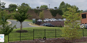

Looks good. Did they fill and rebar the cavities?
filled the cavities with gravel but no rebar. With 2-3 feet of wrapped gravel behind the wall, contractor said it will be fine. We are also grading out the upper slope considerably. I trust him as he has done some mega walls that you see around shopping centers like the attached
