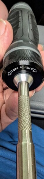

Normal bits do NOT work with Chapman drivers, spinners, or ratchets. Chapman does not use magnets to retain bits and extensions. This is intentional for use with sensitive electronics. Non-Chapman 1/4" hex shank fit into the tools, but without a ball detent they are not retained (they fall out). Even worse, most bits go straight through the ratchets and spinners because they do not have a raised lip like the Chapman bits. So the ratchets and spinners are only easily usable with the Chapman bits with the ball detent.
Chapman bits work with some other products. A rule of thumb is that anything with a back end like the Tekton mini ratchet (2888) and Pittsburgh 92630 right angle screwdriver will not work. If the driver can work with a double sided bit, it probably will work, but most bit drivers and handles are too shallow:
  • PB Swiss PB 451 M magnetic bit holder, handles, and ratcheting screw drivers. Nope
  • 6 point 1/4" shallow socket. Nope.
  • LTT Ratcheting screwdriver Nope
I did have some success:
  • Tekton ratcheting screw driver. Yes
  • Chinese SK handle with a strong magnetic. Works but shallow.
  • Tekton comfort grip handle bit driver. Works but shallow.
  • SK Deep 6 point1/4" socket. Yes
  • ICON Locking flex head & ratchet bit set. Bit Ratchet yes. Handle end extension Works but shallow.
  • Gearwrench 1/4" drive 6" 72 tooth bit ratchets. I tested with the 6" and 12" flex-head 81025 and 81030 ratchets. Yes

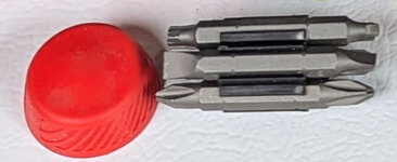

  • Megapro 15-in-1 drivers. Yes. This uses regular size double sided bits.
  • Megapro Amigo. Works but shallow. This uses short double sided bits.
  • RolGear ratcheting screwdriver. Works but shallow. Best back-drag ever, try one of these.
  • Craftsman 47480 10-in-1 screwdriver. Yes. Uses double sided bits.
  • Craftsman CMHT68129 Ratcheting Screwdriver (SpeedDrive) with 2" doubled ended bits. Yes.

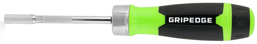

The set includes a ratcheting screwdriver. It is shown below with the 5.3" extension installed. The extension can be removed (just pull it). Do NOT insert a bit into the handle with extension removed. DANGER! It is possible to push a bit fully inside the handle (or at least it looks like it). The extension can seat a full 1" into the handle and the bits are only 1" long. There is a positive detent based on the extra grooves (detents) on the bits, but they will easily push past that. I checked. Don’t do it! Only use the bits with the extension.
The ratcheting action on the ratcheting screwdriver is unremarkable. It works and supports right, left, and locked in place. I find the handle to be a bit on the large side.
When I tried a Megapro 15-in-1 I thought “That handle is horrible”. It is mostly a cylinder with a 35mm diameter. I really dislike these for my hand size. I rarely every use these. Good to put in a car I suppose.
The craftsman ratcheting screwdriver (CMHT68129) is also 35mm at its largest and I had the same initial impression, but because the handle is not a straight cylinder I find it very usable (but heavy).
The GripEdge ratcheting screwdriver at its widest point is 39mm, so even wider. For my hands the ergonomics is not great.

CMHT68129 Precision ratchet screwdriver​
Screwdriver with bits in the handle (about $24). Nice action and bits in the handle. This this is heavy.
Each bit is double-sided and 2" long. This works with Chapman bits.
The following bits are present: S01|S02, T30|T25, T25|T20, PH3|PH2, PH2|PH2, PH2|PH1, and 1/4"|3/16".
There are two T25 and four PH2 bits.
The bits fit in the handle in a case so things do not rattle around
I bought this driver because it was on sale. Then I thought it was too wide and too heavy. I find, however, that this fits well in my hand because there is a finger hold where it narrows. Also, the back-drag is surprisingly low. My only complaint is that you cannot lock the ratcheting mechanism and use it as a regular screwdriver. Change direction by pulling / pushing on the back part below the handle. It is very easy to switch. My guess is that this is roughly 72 teeth, it feels very fine. The mechanism is a bit on the noisy side but very smooth.
I bought mine at Ace hardware. Walmart sells this for $30 and Amazon has it on sale for $15 right now.
Between the base of the handle and the portion that you push / pull to change direction, there is a large black collar. You can turn this collar with your fingers to turn the screw driver. This is a very nice unexpected feature. Even better, this collar works with the ratchet so you can hold things in place with one hand and use that collar like a ratchet. I have not seen this on any other ratcheting screwdriver. It might be even better than having a knurled shaft; it does not have a knurled shaft.
The appearance is sufficiently similar to the Williams JHWWRS-1 Magnetic Multi-bit Ratcheting Screwdriver that I expected them to be very similar; they are not because the williams:

The T-Handle Bit Driver is nice and comfortable in my hand. Both ends are magnetic. I kind of wish it was ratcheting, but it is nice.
For me, the 1/4" Hex Ratcheting Magnetic Bit driver is a mixed bag but usable.
  • The bits are held well (magnetic)
  • There is nice knurling in the shaft (big plus).
  • The top of the handle screws off. You can fit 7 bits into the cap (nicely thought out) including the long ones because the handle is hollow and deep. You could drop a bunch of bits into the handle as well.
  • The handle has four “divots” that provide a better grip and prevents the screwdriver from rolling (nice).
  • I find the driver a bit large for my hand and I find the Snap-On driver more comfortable in my hand. OK, I find most of my ratcheting drivers more comfortable in my hand. I like this handle better than the MegaPro multi-bit drivers that I disliked enough that I gave them to a friend (who loves them).Personal preference.
  • If you look down the handle there is text FWD and REV. If you twist towards FWD, then you tighten. Twist towards REV to loosen. To see the marks, you must look down the shaft, you cannot tell by looking on the side of the screwdriver. So how do you tell without trying to rotate the metal collar? The metal collar is black. Directly behind the metal color is a solid gray section followed by a solid black section, followed by another gray section that is not solid all the way around. If you align the o between FWD and REV, the shaft is locked. If you then rotate the FWD direction, which puts the driver into “tighten”, the break aligns with REV. If you rotate in the REV direction, which puts the driver into loosen, the gray section aligns with FWD. So, a little odd, but it works.
In the last week, I have had three failures with new Proto products (Zoro is taking care of those) and one used product (Proto is evaluating that). Because of this I am very sensitive to how a ratcheting mechanism feels, especially on my Proto things. Remember this.
On first use, the screwdriver reverse felt similar to two product failures using only my fingers (so no heavy load) and I keep expecting it to fail; but it has not. If there is a bit of odd pressure on the shaft (side pressure, for example), the ratcheting mechanism feels like it is catching (but it does not). In other words, it is not as smooth as my other ratcheting screwdrivers.
I expect that it will wear in with use, but only time will tell.

Drywall #2 Phillips bits are slightly smaller in diameter and are designed specifically for hanging drywall. The smaller diameter allows the bit to fit deeper into the screw head, creating a more secure lock and reducing stripping. This can make it easier to drive screws and can also reduce operator fatigue. I also own some of these from Vessel.
I wanted to try their discontinued Ratcheting Screwdriver. The screw drive is OK but not great. Backdrag is very good, you can get many bits into the handle, but I don’t really like the handle. The ratcheting action is better than the Proto, but pretty much everything else is the same or worse than the Proto. For the price, this is much better than the Proto ($117) and the Proto only has 91 pieces. But I prefer the Proto.
Everything is labeled well with a decent selection including bits not commonly found and no longer offered by Tekton (like the PH4 and drywall bits).
I don’t usually need the smaller 4mm bits while I am using the 1/4" bits. For the price, you get a nice usable selection, and if there is something that you want that is not included, just toss it into the ratcheting screwdriver handle.
This is a great set if you want a beater and a bunch of bits. If I just want a beater ratcheting screwdriver, I probably bring my CRAFTSMAN Ratcheting Screwdriver, SpeedDrive, 2” Double Ended Bits Included, Handle Holds Up To 6 Bits (CMHT68129) for $15, but it cannot take other bits, or I bring my Williams ratcheting screwdriver, which is cheap enough I do not stress much if I beat it up.
