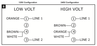

Hi All, I need some pointers. I had an electrician install a dryer plug on a 30amp circuit into my garage which I believe is the NEMA 14-30P style outlet.
Sometime later I purchased a dual voltage compressor which is factory wired for 110V. Now I purchased the 4 prong cable and I'm having trouble rewiring the unit to run on 220V.
Firstly I have opened up the motor access plate and followed the diagram to switch jumpers from the low to hi voltage configuration. I've tripled checked this.
There is no wiring diagram for the pressure switch. So following some google searching I've hooked up my 4 prong dryer cord as thus:
Red wire - Switch Line
Black wire - Switch Line
Ground - grounded to switch plate/compressor body
White neutral - Capped/not used.
When I turn the compressor on it does not run. I have tried switching the red/black lines and no effect. Measuring between the Red/black wire shows no voltage with multimeter. Measuring past the switch to the motor Line 1 and Line 2 terminals with switch ON shows current with my non contact pen.
Please any advice?

Check your receptacle to make sure you have 240V between X and Y.

Could be beeping because phantom voltage, or one leg is dead.
Make sure your meter is working by testing in a known live receptacle, 120v or 240v.
Check between X and G and Y and G to see if a leg is dead.
Check in the panel that the breaker is actually on.
Check the voltage on the breaker screws to rule out a bad breaker.
Turn off the breaker, pull out the receptacle, and check for correct wiring.

thank you, I am measuring 120V between Y/G and nothing at X/G assuming this is dead. Will be calling electrican back to fix the wiring.

a couple of things that are incorrect here
compressor doesn't need a neutral so the 4 prong 14-30 dryer outlet is incorrect
you need a NEMA 6-30
and thus the 4-prong dryer cord is wrong as well.

You only need a cord with a 6-20p on it. I'm not a big fan of adaptors, but they do make one. You could change the receptacle to a 6-20r also, but if the 30 amp receptacle you have now is in a 2-gang box, that wouldn't be to easy to do.

You show wiring for the switch for proper 240v operation, good. Have you also rewired the MOTOR for 240v operation??
