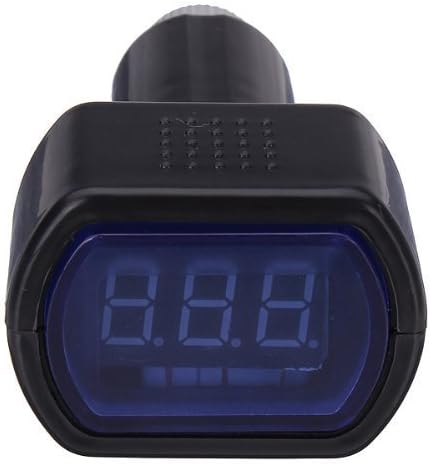

Most electrical problems in a car center on the battery or charging system. To keep an eye on things I bought a bunch of these cheap cigarette lighter voltmeters.
These are good, anyone in the family can use them. If there is an issue first thing plug this thing in, what is the voltage reading? What is the voltage doing when you try and crank it over? All for around $7 or so.
Buy a couple, you won't regret it.

I do have printed copies of the wiring diagrams in the glove box and saved on my phone haha. I like that cigarette lighter voltmeter.
