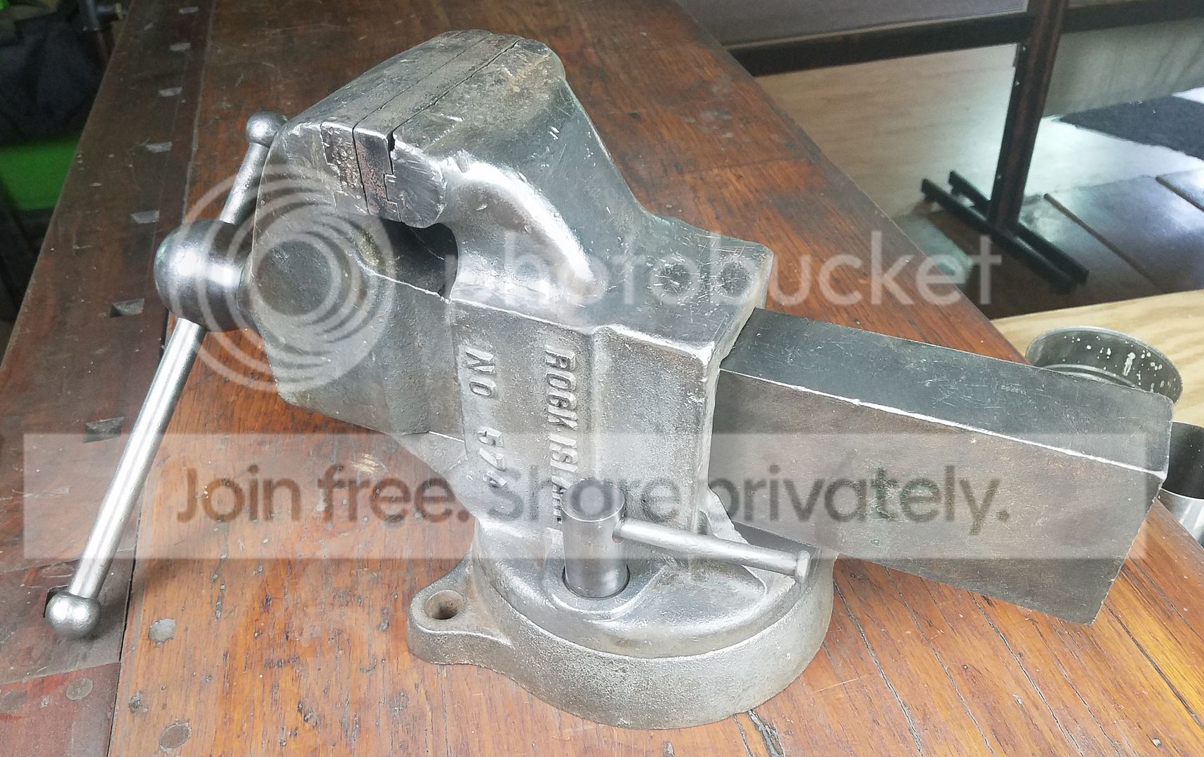

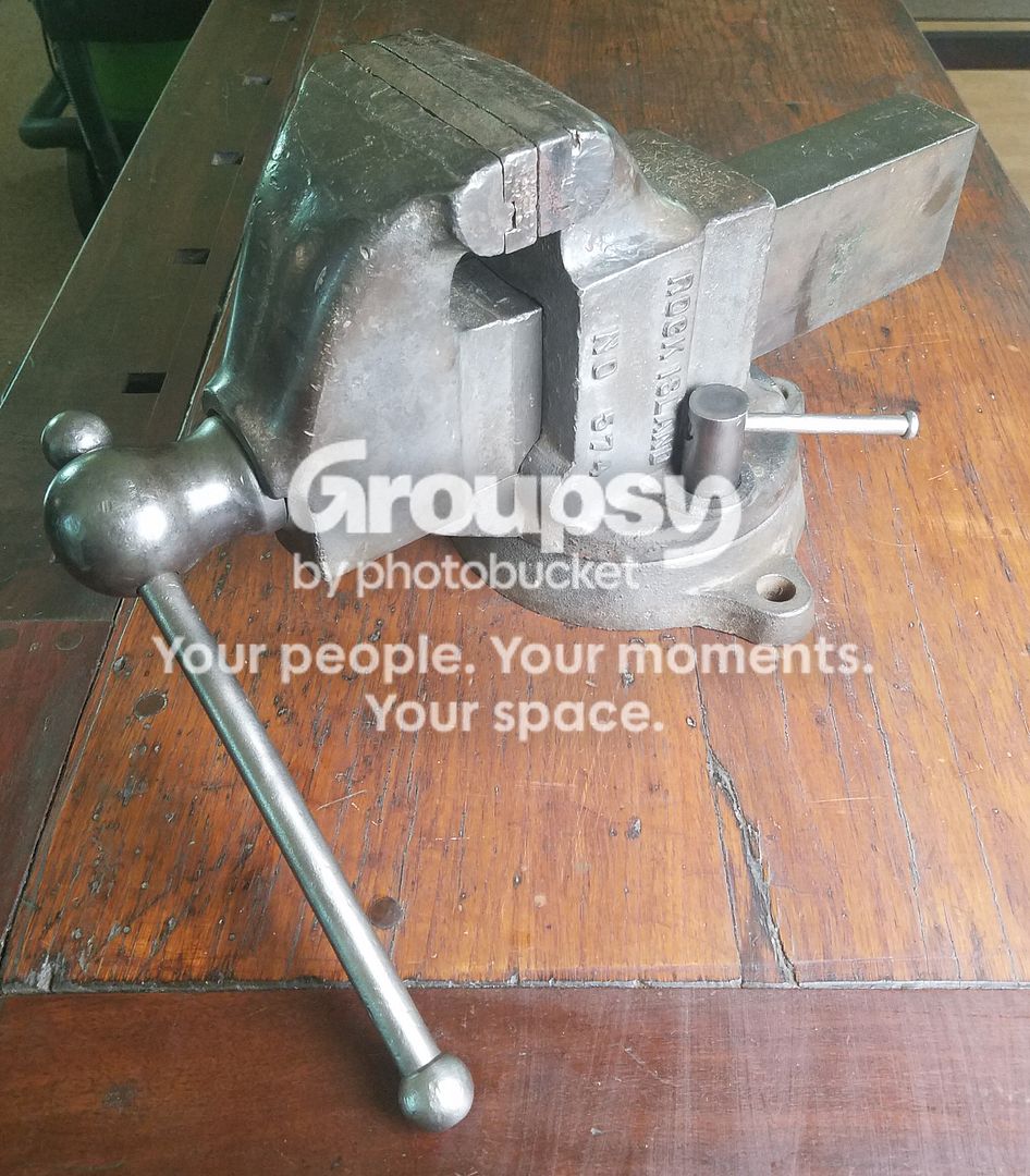

I decided to take apart, clean up, lube, and repaint my grandfather's barn vise. I've had it since he died in 1983. It's a Rock Island 574. Everything works, but it's missing the center bolt, and there appears to be little left of the old lubricant. The upper part was held to the lower part only by way of the swivel bolt assembly whose pin is bent. I think I can straighten that again. In watching videos about restoring vises, I found cfkbjVgLoSA on YouTube is also a Rock Island 574.

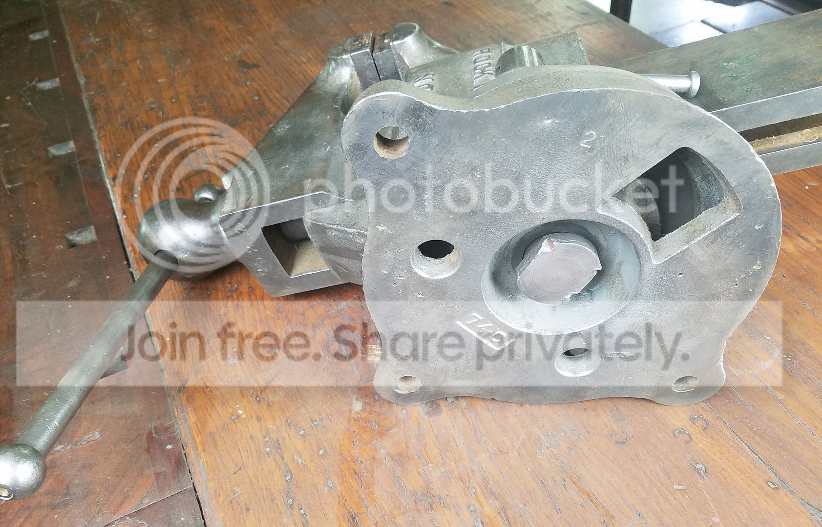

The big question is to know how to replace that center bolt? In the video, it looks like it's a stepped bolt of some sort. It can be seen starting at the 29 second point of the video. I looked for parts, but could only find jaws available. Is a replacement for this part available? Can I fabricate it using a bolt, a nut, and some washers as shims?
I saw in thread 294705 of the Garage Journal that the owner of the same model found USN (for US Navy) stamped, but I don't see where he found it. My grandfather bought most of his tools as military surplus. The inside of the jaw face plates are both stamped 75.2 but if there's a date, I haven't discovered it yet. Do you know where to look? (ETA, see post 15 of this topic).

Still wondering how to approach that missing center bolt; ideas or suggestions?
ZRX61
Aug 15, 2006
28,716
Solar Blight Valley, SoCal
If you can find a regular bolt with the correct thread, a piece of tube to act as the shoulder & a big washer you should be fine.
Failing that, maybe someone will have the bolt specs & you can have a machinist make one.
I needed a special bolt one time & someone at the local college Mech Eng program made one as a class project. Did it for free too :)

I looked at the 574 in my bone pile. All it has is a jaw pad, jaw screws, main nut pin and the actual vise body. All other parts are gone, including the part that you need.
That said, 574s are common and turn up all the time. You can wait for one or you can make your own base screw. I would use a high quality screw if you plan on making your own.

Someone from Garage Journal had a spare center bolt he salvaged from a Rock Island 74. We hoped it would fit, but it would only thread a turn before stopping. After deciding I didn't have the tools to measure or cut, I took the parts to a nearby machine shop. Two weeks later, and he had the parts fitting. He said it required only for the female threads to be re-cut.
I really like how this is looking, and I've only done preliminary wheel wire brushing so far. I purchased a gray hammered paint that's a bit darker than the original battleship gray, but I'm thinking about torching the parts, and applying boiled linseed. As you can see, it's pretty banged up. I'd be appreciative to read your thoughts.
Hi there, I have the same problem ... Missing center bolt for my 574. Do you remember what bolt you gave to the machinist to modify for this? and do you have the name/number of the machinist? i'd like to have him do the same for me if possible. feel free to DM if you like. thanks.
johnxman
Aug 8, 2021
3
I would like to report that I have "solved" the missing centerbolt problem in my Rock Island 74. The bolt that is needed is a 7/8"-14 thread hex head bolt, 1 1/2" long. However, the bolt also needs a sleeve/bushing approximately 1/2" thick and 1.25" wide (o.d.) to ride just above the bolt head. This bushing ensures that the upper body of the vice rotates smoothly with no slop. Since i didn't have a handy machinist to make a special bolt/bushing, i went to McMaster Carr and got a bolt (part no. 92620A920) together with some "hard fiber washers" (pack of 10 -- part no. 96100A157) which have i.d. 7/8" and o.d. 1.25". I ended up using about 8 of the washers around the bolt. i then put a modest amount of axle grease between the vice parts, and bolted them together using the bolt/washer sandwich. It went together smoothly and snugly, and it now rotates perfectly and locks down securely. problem solved. The folks at McMaster CArr were incredibly helpful in finding this solution. (note that the picture i'm attaching of the bolt is actually the 2" long version. this is too long. get the 1.5" to avoid cutting it down.)
