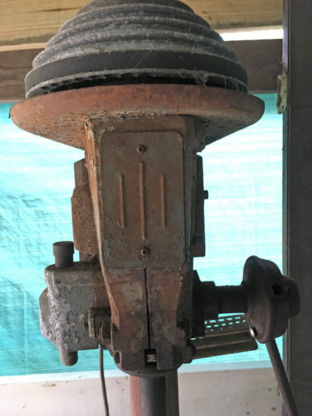

I was given an old 17-600 (1964? #1339409) if I would come and pick it up. Can't say no to that!
It was stored in a covered and semi-closed shed in South GA.
It is in poor shape BUT, amazingly enough, fires up and works without any obvious problems.
My questions concern missing, missing/broken, broken parts.

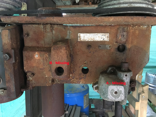

A - concerns the feed dial. It is missing and I can't even find a picture of what it should look like. Does this control the set depth of the drill?
B - concerns the crank/gearing assembly which appears to have never been there. Does this control belt tension?

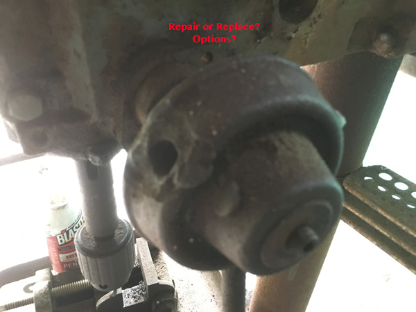

C- concerns the hub. One handle is still there held in by a screw. Really bad shape. Would a Clausing hub work as a replacement since these seem to be hard to find?

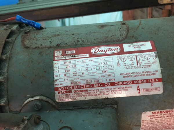

Finally, here is a pic of the motor that was used to replace whatever was here originally.
Thanks for any help/tips you can send my way. I'm sure I can bring this back to a much cleaner, working machine - but I don't want to be going down a road with no good ending.

A - That does look like a feed dial/indicator. As long as you have a good spring inside that housing you could probably get by until you can find or reproduce the missing parts
B - This is a rack and pinion assembly for lowering and raising the head vs the table. Generally you can transfer the table raising mechanism parts to this housing. I believe these DP's came with only one rack and pinion system for the user to choose what part of the DP should be raised or lowered. (head vs table). Or both if you can find another rack and pinion kit.
C -I don't know but these Delta/Rockwell hubs shouldn't be too hard to find. I usually see them on Ebay.
D - Yes, or better yet, a VFD control panel.
Start putting together a list of what you need and take it over the the BOYD thread at OWWM. I've found the members there are very helpful with supplying some hard to find parts at reasonable prices. Also check with GJ member 454ragtop. He might have some more 17-600 parts. (He saved my **** on an otherwise unobtainium part!!)
You **** to get this one for free. Rough but a rewarding project and a wonderful machine when complete. My advice is to disassemble it completely and start the restoration from the ground up.
Make sure you service or replace all ball bearings. (4 in the quill/spindle assembly and 2 in the motor). A spun bearing can ruin a hard to find spindle.

After getting home today I began removing parts to find what was missing or broken. So far I have been pleased with the ease parts are coming off.
I plan on attempting to repair the hub - and I am not worried about adding/replacing the head raising mechanism since the table raising mechanism is complete and functional.
The parts I know I'm going to need are all on the depth stop housing -
(The group of parts that contain/control the feed dial)
Screw - SP-732
Knurled knob - DP-544
Spring - 928-01-041-5879
Washer - SP-1610
Feed dial - 402-07-037-5001
Plus -
Lock screw - NCS-178
Brass plug- 402-07-074-5001
If you have any of those parts I would be pleased to purchase them from you.

Sorry can't help with those parts. That's a micrometer spindle stop, not often seen. In fact I've never seen one in real life, only pics. Have had probably at least 15 - 20 of these 17" Delta's over the years, all had the more common threaded rod type of depth stop on the other side of the head. Other than the feed dial, the rest of those parts sound like something that could be fabbed or adapted if you had a good idea what they look like. Probably should ask over at OWWM also as Dave suggested.

I have the same drill press with the same spindle stop! Mine is serial 1326795 with a Dayton 1.5HP replacement motor very similar to yours. Feed dial is missing on mine as well.
This is what the depth stop looks like new:
-7g0P9qrx7z223IgRGxJdNbrrjvnUeY7wzixn0VwfgBNbuUGvKiHehFcZtV6ZuyjInBoEwOn8xJIPnbX_UkqhghaRNcaGxZR-MGBcf0sM4lefqjv6HboalrS_orNMzuU3QujoeJIQOxVr7O2ObdGEsQybK0_--E91OZbNi1Lx6j_eLlJVRQ4kyfCAZEGngIm4qdNlb4GxulOiV0L0R_5JyIEsxJ6S1TS_ficUpQtzsZ0kD2r-gEumQhIqaOKFRgdnrjAHHCt89o-E0JYQXD83xXRNPLprdfCexm1quf4ZIypshk8h4zAxSBfKBxXSEZKFsW-7sIHY56dunQ6VJOLi_sDNgxGLe7kZlVraf5pa_4pGpsb-mkcwE99sPrFFYkFrRQLElZou46rdjRqgcnma1qZxwoIumq1Fr0ko4rWdhJoDBZDgYPailpbmksR2GTtCZ38SO6l76YlEjoJak9HXsP5HgCiTTmdIEJYSyE2eoKJxJaGTfTFLNFGAyo8cxokYGlb8DbSz9SOKA4T8jXg8Xyri_EnYxMQfoqZeAl92lZQWpVwn2FbJP5_d9hMIK7gNpaAbMqq_90V1D1L-ck32DpQx7WnfSwqlvshTb9ykUxaBKgb9AebuWy4vncbpHM7PWnPkK0z2l-qd0txYKWQnSid6ij5iEisPFcadGVnklN9yTc=w981-h481-no
I ended up putting a on/off switch on the front of mine. I thought about a VFD, but I really don't need that expense or complexity. Punches holes in steel 100x better than anything else I have as-is.
L-qcz8_tCNDYm84RZ_HMlt2jN-tSMyh3xJcfM-X2PKB2v06iSKokN6KhjIwkIqmUXRWkegKij0zG7Xztv-9vhH4FM0lELVXedh5KpZHhGjDfNm0W3_yqxhpSHqFcVlEALPIF5A2T33UG1x0KTr5sbMO-sgYQyYnpPk5I1OZC2qNdAICEsTFKp7JvqInxf2bBQe3-rRF7G-QYBbBYzd5krNQHDgfWzUPs7b-p8fY0XFcpdosyrLXSqWqHX_xa0_1-I-VLKKkQ184sPOuNEK1KBptaq1Um-fwVwREEjXXj6JV0tGET7wymfuRO6oYPcAyhkanDDyu03yeUNxxENg5Mc7NdWOljKITAXUcF0F3HzJjOwJWO41c-btyXT73oGafb9bRV9XEOy_chOPzMagQlrkHr3MwojY8eCCmYDqDicFor_0BMky0gfClIIP2loYfZ8wsyjRDt5PVcnmvd7dRsHJg7d869b4oW_xmLO0aAlcHswB5PMhAex6N4TQTGlQ4zgHLxHMuiAoV7WYPe_Rw4tq7mdu0yGdBP0HZL8PPP22uw4rEL61EFWIaun_x4PrWwVN5osk0eWUMNLNt8HCrozjZ5hCvMtYkfsbsimW-Skzvo15STHGyCDUsLaAFEKs8WDlwZJmyHH0AD6LFAohziI0nLeOOhXtMtA2dCmN-mEGlLzBU=w1280-h635-no
