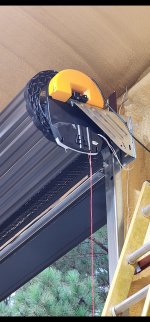

Eta
Easy install and setup. Very quiet. Expensive , kind of, but other places were similar in price.

that yellow opener is what i was referring to. it only draws 2A vs 11.2A for the liftmaster. now that I'm looking again, the easy roller and Hiro motor might be the same thing, just one site is charging much more. for the $1k they're charging, it be worth it to look into a Liftmaster which is a few hundred less? I'll be getting 3 doors total.
is it possible to use a motor while stilling having the chain option?

The easy roller and hiro are not the same. The hiro is a heavier duty motor. They do look similar.
Looking at the specs the easy roller is good for up to 180sq ft of door. Too small for a 14x14 which is 196 sq ft
The hiro is good up to 300 sq ft.

ok so it looks like I'd need a kit to be able to use a lift master opener which adds about $200 per door.
another thing to take into account.
