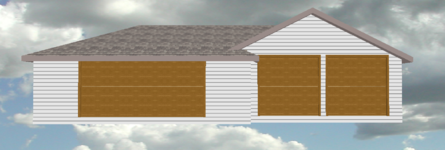

I drew this up quick in a basic architectural drafting plan. I assumed 9' ceilings, 8x8 doors in existing garage, and a 16x8 centered door in the new. It is drawn with 6/12 pitch roof, 12" deep soffits, and 4" walls.
The CAD program did pull the peak offset at the original front garage, I don't know how to correct that. I think it did it so that the ridge of the new garage would not overun the peak at the existing. This would be a relatively simple overbuild to achieve and rework of the soffit above the existing garage doors.
The plan view shows the ridge lines of the roofs. Hope this helps.

Your drawing over complicates it Larry. If you utilized the same roof pitch as the existing, being as the new is wider, the new ridge would be HIGHER than the existing, so the new ridge would break back down at 45° hips to match the right side pitch of the existing roof and the new front valley would start where the front hip meets the existing ridge. No reason for the offset ridges on the existing roof...unless I've forgotten to much roof framing since my 32 years as a framer taught me...which is possible!
Not sure I am following you.
The OP never stated the original pitch. Some speculated 12/12 but it is clearly less than 45 degrees. So I modeled both at 6/12 on a whim as that is what my eye guessed it is.
I clearly explained that the CAD program offset the ridge without my control and my thinking for why it did it was to ensure that the peak on the new garage did not overrun the peak of the now shifted old. Yes you could keep the ridge of the new section higher and clip it down to match the old; please show us with your CAD model.

Unfortunately, I'm not a CAD guy...at all, but you can get the idea in this pic. At the point where that 'broken hip' intersects with the existing ridge is the point where the opposite valley would start and terminate at the inside corner of the building offset. Hopefully the pic and my explanation helped.
