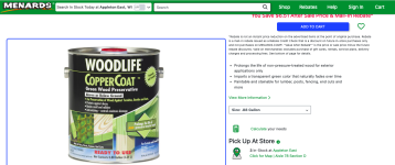

I've been dousing (spray bottle) the good side with an old gallon of Woodie Penta I had for at least 20 years. But I'd prefer to use Copper-Green Wood preservative, if I could find it anywhere. HD nope. Lowes nope, ACE nope. Even Amazon, found it but they won't ship it.
Snip's
Apr 29, 2017
1,877
Menards In Appleton East, Wisconsin has 3 Woodlife CopperCoat in Aisle 78, section D...

I wonder though if that is the same or as good a product as the Copper Green brand.
I was able to order the product I want through Lowes with free shipping too.
