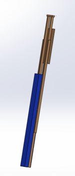

It gets complex pretty quick but hears what I came up with so far. 2x3 fit into the columns as shown in picture 2. 2x3 seem to only be available in 8 ft lengths so need to be spliced. Challenge is that the cross bar on top needs to be about 5' above the column to allow 3 ft space for the carriage and an additional 2 ft for a come along. If you just use a pulley you will be putting 2 times the load on the wood columns but you can bring the cross bar down to about 3' 6". Worst case is you bring the crossbar down to just over 3' and use a threaded rod to jack the carriage. That would be a lot of wrenching about 3 ft of it but if you have a low ceiling, might be the only option. I added a 2x12 to the back of one side to stiffen up the extended 2x3's that 2x 12 needs to be spaced off the 2x3s to allow clearance for the carriage. There needs to be about 1 ft of space at each end of the 2x12 to allow room for the arm fittings at the bottom and access to operate a come along handle up top. I may opt for the threaded rod method. Its long but with shorter extensions a lot safer. And if you lift and block the carriage up in 6" increments, you can spin the nut up quickly but carefully.
Also you will need to put spacers at the bottom to hold the 2x3's off the hydraulic line or remove the hydraulic line from the cylinder. A piece of channel would be best for this.
You will definitely need to be careful with this. And a pro with the right equipment id highly advisable. And keep in mind this will only be able to lift the carriage up enough to replace the sliders. You will not be able to completely remove the carriage out of the lift.
If you have access to good steel 2 pieces of 2 1/2" square tubing would be the best. Or even 3" round pipe.

I started making the tool out of wood and then I found some 3" x 1.5" rectangular tube I had lying around. The 3" fit right in nicely on one side of the column but I had to mill it down 0.025" on each side to get it to fit on the other side. Fortunately I have a milling machine so all was well. I was able to just use 2 4' pieced and bolt them in with the two screws that hold the column extensions in place. Those screw holes are threaded so I drilled the top one to 3/8" and as accurately as I could I drilled the bottom one 6.5" below it to 13/32". This way the screws just pass through the holes and cold it captive. I was also able to put a nut on the bottom hole for safety but really un necessary due to the tight fit in the column.
A threaded rod will be used to jack the carriages out. Its a slow process requiring about 450 turns to get the carriage clear but very stable and safe.

Able to import the pictures into Word and save as a PDF

It looks like that'll do the trick. That's going to be a ALOT of turns!! Could you put a spot weld on the bottom nut to the housing and then double nut the top so you can use an impact wrench to spin the threaded rod?
I wish we were closer so I could borrow your rig so I can do mine, ha!
In the end I double nutted the top and ran it down with an impact. But I had to do it in 2 steps because in order to connect the threaded rod I had to use a 4ft+ rod to catch the carriage with it resting on the top ratchet stops. Then the rod bottoms out so you have to prop the carriage with a two by four and switch to a shorter 3' rod. If you have a helper you can just manually push up the carriage and have your helper place the 2 x 4. Then you can go right to a 3' threaded rod. You also need to make sure you have the 2 x 4 in place when you let the carriage down otherwise there will be a big noise.
Not two difficult to make this. If you don't have a milling machine and your 3" rectangle doesn't fit you could use 2.5" with shims to tighten them or just make them out of wood and pre drill and use lag bolts.
