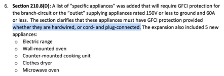

So I have done a significant amount of wiring on my garage/shop with praise from the inspector on the neatness/origination/general work, but I'm struggling with rough in for my Double Oven and Range top of my kitchen.
Both will be 50amp circuits so 6/3 per the appliances my wife has picked. I plan to mount the junction boxes in the back the cabinet for easy of wiring. Is it as simple as fastening to the stud close to where the box will be within the cabinet and leaving a whip of wire to come through the sheetrock.
Plan is for 4x4 metal box with NM-Se Cable connector.
Last part to get my rough in completed prior to getting the inspector out.
