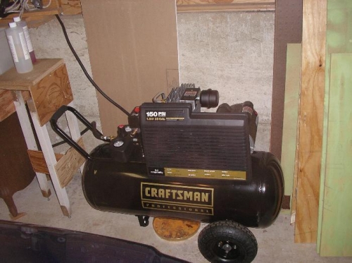

Regardless it would be neat to have people take 2 minutes to post up the model of their compressor, the rated CFM (if available), a picture (if available), the drive pulley size, motor RPM, horsepower, and Flywheel size. Lets see what is typical. There are only a hand full of designs out there, lets see what we can learn.
