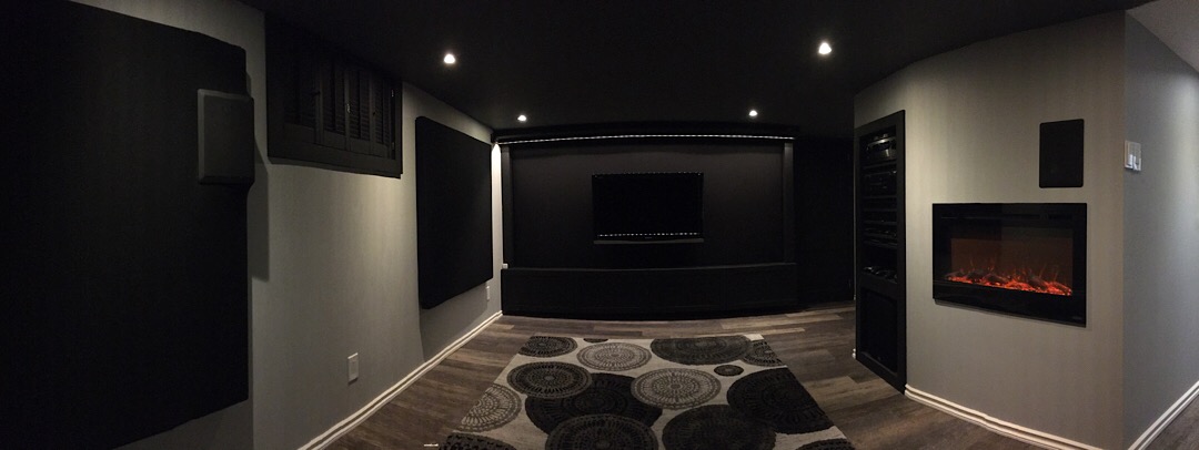

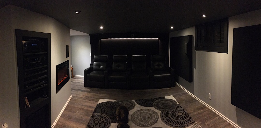

In my theater install, I ran all the wire for various components in the wall (power, HDMI, LAN, speaker cable etc), and ceiling. 2" conduit is run from the media rack to mechanical room and both ends of the theater where hidden acoustic wall panels give you full access. The conduit is empty. That's the way to future proof :)
Clean install with easy access for whatever the next level of HDMI, network, fiber etc. requires :) This is a 100 year old house so access is always an issue...
