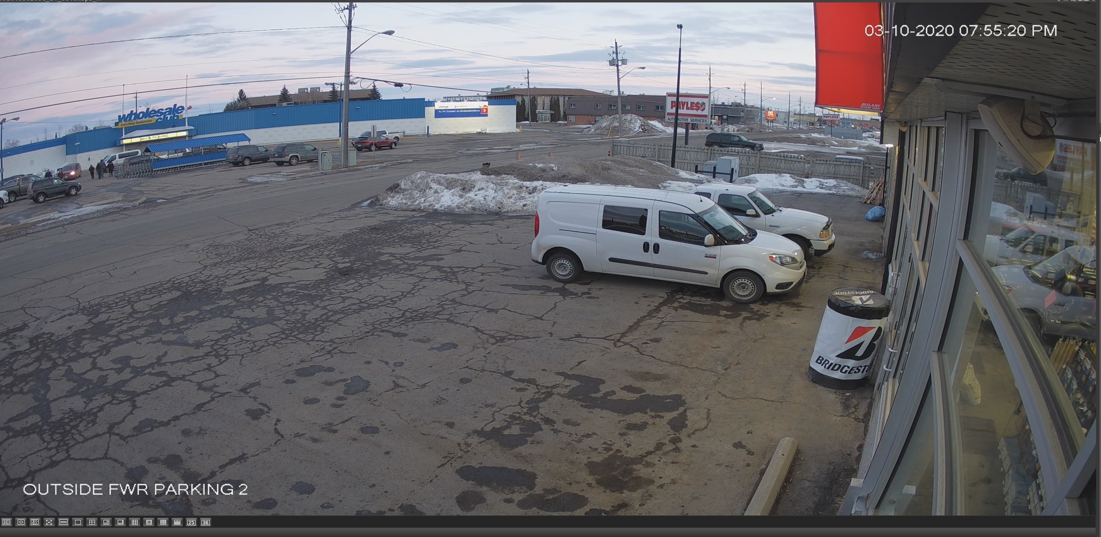

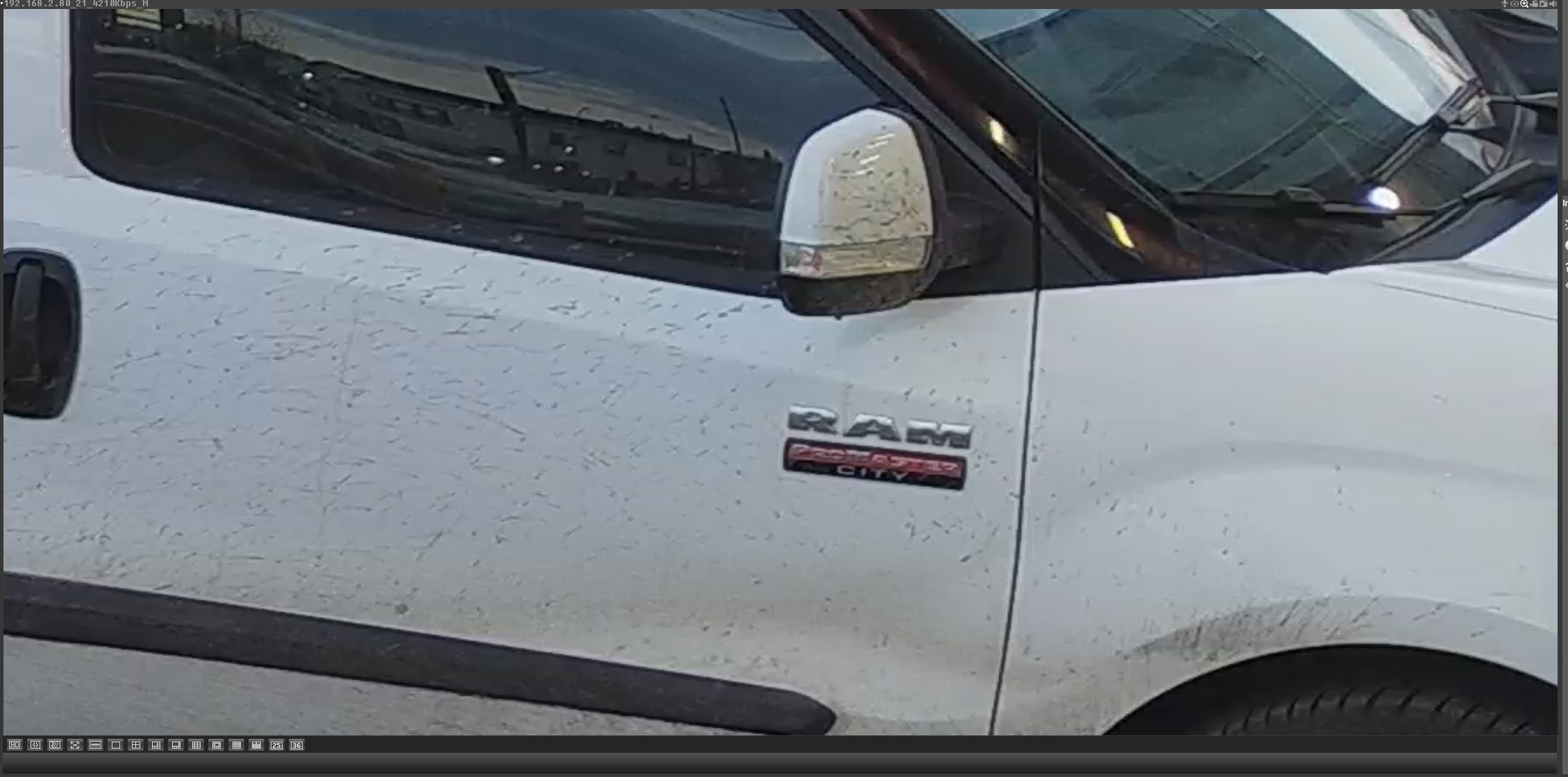

HD 4K is the way to go. It really pays off when you can read the plate on the car parked in front of your house.
My system is HD....I can read a plate of a car parked in front of my house....but if I had 4K, I'd be able to read the plates on those cars across the street.
This is the view in front of my house right now....I can monitor from work or my phone.

Call me a little skeptical, but I would like to see a pic from that camera where you can actually read a license plate on a parked car. Bonus points if you can read the license plate on a moving car in front of your house (but I don't think that will happen for sure)
Lastly, stationary objects in broad daylight are pretty easy, how about a pic from the the middle of the night?
Parked across from his house at an angle to see the plate, it would be easy just zoom in and enhance it a little. If you have the right day/night camera, you can read it just fine at night. I am looking at a camera at work right now in a parking garage. I can read the license plate on a car leaving the garage from about 30-40 feet from the camera with no zoom or enhancement.
I think you have been watching too mutch TV. We are talking about fairly inexpensive cameras for residential use, not something in a commercial location.
Hey, it's the internet. You can say whatever you want, but I am still waiting for the pics from DD where you can read a license plate on a car parked in front of his house from his camera that probably has a 4mm lens

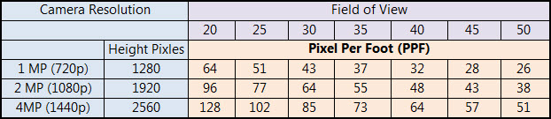

Nobody said anything about price level of camera. A couple hundred bucks will buy you a good quality camera. Ddawg's picture looks like it came off a pretty high resolution IP camera. So I suspect it could. This 4 mm lens camera could do it.
https://www.amazon.com/HIKVISION-Camera-DS-2CD2042WD-I-high-resolution/dp/B06WRSVXKW
DD said he has a "Lorex camera system that is HD". Nothing wrong with Lorex, but when you get 4 cameras and a NVR for $300 (or 8 cams for $500), your not exactly talking about high end.
'4K' is the new buzz word. But out of all the specs, that is probably the least important. #1 would be the sensor size. Just like in a digital camera, the bigger the sensor the better. Just google 'lorex sensor size' - you will have to do some digging to actually find the size, because all they mention is how may megapixels it has. I finally found one listing that indicated 1/1.8” which is on the low end side of things and will definitely affect low light conditions
#2 would be the lens size. When you buy one of those prepackaged system, you don't really have any choice, and they don't even spec the lens size. 4mm is probably the most common, but to pickup a license plate or an identifiable face of someone walking down the sidewalk, your going to need something more powerful.
The Hikvision camera you linked to is a pretty decent camera, but even then, I don't think it is going to show a legible license plate at a distance.
I said I was skeptical - let DD post a picture with a legible license plate and prove me wrong.
"Pulling into a driveway" is completely different that a car being parked on the street. With the way that camera is mounted, it ain't going to happen - the angles are all wrong

I grabbed these off one of our 4K Lorex cams. They are 3840 x 2160 res. Image 1 is a full frame grab, image 2 is a digital zoom. Cams are about $250 each, but cheaper if you buy them (as we do) in sets of 24 or 32 with the NVR. 4K at 15fps is fine for our needs.
Pics are cropped/compressed for web (still caps from the software are 3-4MB), but you get the idea. Click the pic to enlarge:
We have another site that I can't post pics of..but trucks about 60ft way I can read the plates no problem with a digital zoom (night). Pushing 100ft, not easy without software...
I will admit - I am impressed with those daylight shots, although $250 per cam for DYI/Residential use is getting up there in price.

So that comment i made about reading a plate at 60ft with a 4K cam and 28mm lens is about right zoomed out at 112 degree viewing angle. They are saying 40 PPF as the threshold for a plate read.
From that post:
The image I posted previously was from an 8MP camera. Field of view is pretty much dictated by the lens focal length and effective zoom on the camera. In other words, the wider the lens angle, the shorter the 40PPF threshold will become.
