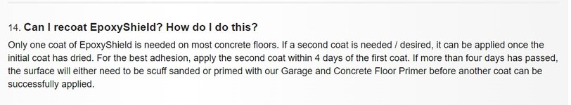

Justin Thanks for the reply. Regarding recoat times, I specifically asked Rustoleum customer support if I needed to sand if using their clear coat. I also let them know the floor had been installed for about 15 days. They told me it was not necessary, just clean/degrease and allow to dry before using the Epoxyshield clear. Does that sound right?

Rust-Oleum's customer service department usually is very good at helping customers with issues. Unfortunately, it isn't always the best in terms of providing the most accurate information. You have up to 4 days to recoat EpoxyShield before deglossing and roughing up the surface is required. You can find that information in their FAQ sheet here. It's number 14.
As Justin stated, a polyurea clear coat would be a great option. It will provide much better abrasion and chemical resistance than the EpoxyShield clear. Because the clear coat is the wear coat, the overall coating will last longer as well.
