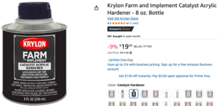

I just picked up some Krylon Acrylic hardener to use with some Rust Oleum along with a new HF purple cheapo spray gun...
This will be my first attempt at this type of painting... I have a vintage Delta machine stand that I will be refinishing...
