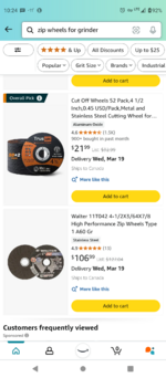

Do you have a particular disk in mind you could link to here, just so I can see exactly what you mean? I have the dewalt 4-1/2 grinder.
Walter is the "zip" trademark holder. Its being used as a generic name for a very thin grinder wheel designed for cutting not grinding. Pic is of Canadian website, american site should be significantly cheaper. Your local welding shop, lumber yard, or harbor freight will have singles for sale for you to try. Cheap is OK, but brand name is significantly better lasting.Screenshot_20250315-102445.png
Nice. The width is 3/64" (1.2mm), that's incredibly thin! I'll get some of these one day. Thx

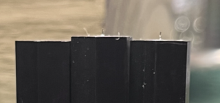

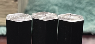

@Beerhippie I've got some of the 0.045" cutoff disks now for my grinder. Would you say I could get a more-even cut using both the drill press and the grinder together like this (this is not the correct disk installed in the pic). Too dangerous? I'd be wearing full face and neck protection and decent gloves. Alternatively I can just wing it in a vice and eyeball 90 degrees.
I wish to hell I had that set-up!
Advance the grinder slowly, be sure it's as close to 90 degrees to the material as possible and I think you'll get lathe-like results!
