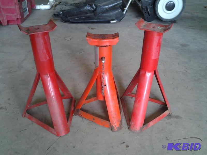

UNSAFE....
In the 80's, the parts store sold a **** load of these tri-pod stands:
Their stability was at the mercy of six chintzy tack welds at the bottom. It is my understanding they're unacceptable by OSHA and are no longer permitted in shops or to be sold in the US.
If you have any of these, please do yourself a favor and get rid of these widow makers.

The sheet metal tube stands are dangerous. They collapse easily and dig into the ground and tip if the ground isn’t solid. I still use mine, but only to hold a trailer tongue or perhaps a rear axle, not attached to the car.
The small two or three ton stands with the ratchet height adjustment locks are a little better, but I rarely use them. The larger six ton stands have a larger base and are much more stable, plus are taller, so that’s what I use and recommend.
Some of the small aluminum stands that are sometimes packaged with the light weight aluminum jacks look sketchy, at best.
