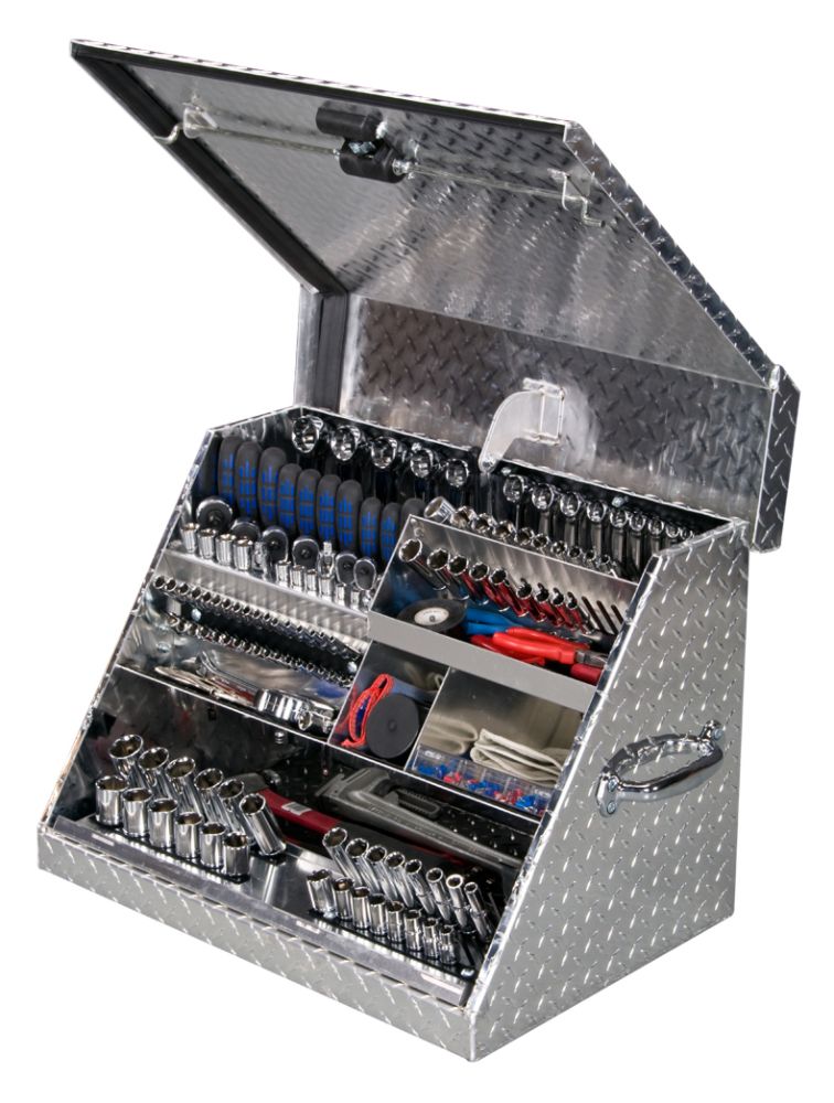

Another new thread has intrigued me for very compact, very easy to access tool storage. A small version looks like this:
009_87706_A
and the thread is here:
http: //www.garagejournal.com/forum/showthread.php?t=126874
Now just imagine making a wood version with say finger joint corners etc.
They make these boxes in 26, 30 and 36" widths (at least), and I think these have much more potential than any top box with drawers. (I'm not a fan of large top boxes myself generally)

Outlaw - now that's intriguing - speaking of "outta the box!" Yah, the trouble with a normal lidded box in that constrained space is that I will have trouble seeing into the top.
The design you show is interesting. It does seem optimized for sets of things, not random clusters of tools, but it has potential... I'll go learn more.
