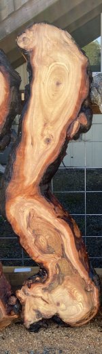

Here is a few boards after a few passes through the planer
If I were to do it again, I would cut a bit thicker, and plane it down some. It’s really beautiful when used. Here is where that first picture ended up.
I’m cutting it 2-1/4” thick, hoping that gives me plenty to plane.
You guys know that a planer sort of ***** for cupped/twisted boards, right?
The rollers push it flat, so you get a thinner, smoother cupped board after. You need a jointer
Yes.
Only boards that are flattened go through the planer
But I don’t know anyone with a 20” jointer, so I built a 12’ x 4’ router sled.
Or a sled.
Or if the roller tension on the planer is low enough, and the wood thick enough, you can do some jointing, but not enough.
