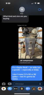

Bringing this back from the dead… just got an older Saylor Beall for $150!!
Runs and works great — so even if it’s a clone (I don’t think it is) I think I made out ok :)

With my Preggers wife at the hospital currently but here’s the only photo I have — a preview of the very lame Facebook ad that simply said “air compressor”IMG_2897.pngIMG_2898.jpeg

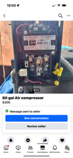

So… I found another “80 Gallon Air Compressor” on Facebook… got it home last night it’s still sitting in the trailer. I had to pay double what I paid for the first one — a blood curdling $300 Ameribucks.
It’s a 705 pump on an 80 gallon tank — not sure on HP of motor haven’t scraped the dust off the nameplate yet.
Guy got it doing a commercial clean out of an auto parts store in Eugene, OR — said he had it sitting for years at his place — and just wanted to get it gone. He took it apart to get it in his truck—and never put it back together!! Made for a very easy load out with just a hand truck and ramps onto the trailer.

here’s some pics — does anyone know what this thing is:

Thanks — that definitely makes sense!
Weirdly enough — the motor/pump config on this compressor
is opposite my other Saylor Beall.
Kinda strange!!
