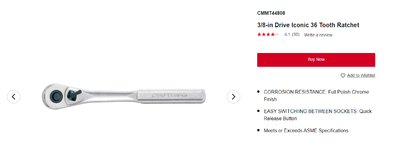

Hello all, I've been trying to get a hold of SBD version of the old Craftsman RP ratchet at Lowes because I have a few USA made ones that I would like to warranty out for the same style. I understand Lowes will warranty it out if its the same part number, however, the Lowes in my area have been out of stock for many months. I contacted SBD to warranty one out hoping they would give me the CMMT44808 but they are giving me a CMMT81748 72 tooth instead and said the 44808 was discontinued long ago. Idk if he meant the Sears version or SBD version so I wanted to know if anyone has been able to buy or see one in stock at Lowes in the past year or two and if they were made in China or Taiwan. Before anyone says "try Tekton" or "I wouldn't use anything but Snap On", I have other ratchets available, I grew up with this ratchet style so I like having them around especially for loaners, junkyard duty and truck tools etc. I don't mind waiting a little longer if its just taking time for inventory to build up around the country. I am in the Los Angeles area. Thanks

To answer your question, yes. SBD/Craftsman discontinued making the raised panel, 36 tooth ratchet nearly a year ago and whatever stock remained on the shelf at Lowe’s has been soaked up by warranties.
Despite the hatred for that particular style Craftsman ratchet in general, the versions sourced under SBD’s reign were not as good as the China made versions that Sears was peddling, and that’s not saying much. I received one from Lowe’s as a warranty that had metal burr’s on the handle. The switch would move itself into neutral position so the anvil would spin freely. It was a true work of art. They say imitation is the sincerest form of flattery, but SBD/Craftsman managed to imitate those ratchets (and even the raised panel wrenches) in the worst way possible. Not that it should surprise anyone…
