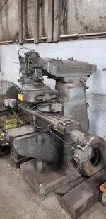

Things are moving much faster than I figured with the home hobby machining idea. I might be able to get this bridgeport mill from work. Was pulled from the pattern shop a few years ago and has just been sitting since. If I get it, the plan is get it home, cleaned up and then have a buddy check it over. I know very little about Bridgeports and wasn't really considering getting one, but if things work out, I'll grab it. Was leaning towards a new import benchtop to get around the power requirements and space, but hell if I can get a Bridgeport, I say go for it.
I do have 220 in the shop so I can convert. The bed is 9x42. 1 hp, 220 3 phase motor. Also I hope the thread title is better.

It's so dirty hard to say. Some sorta weird extension block for the Servo, which is a bummer 'cause you're reaching that much further to get to the handle (which appears reversed for transit - DO NOT crank your X right now)
Grab the table at one end and push/pull - if there's any movement it's worn but you might be able to tighten the gibs
If it runs it's a fine starter machine regardless of how beat up, assuming the price is right.
It's step pulley so just plan to get a VFD

Its dirty from sitting. Being from the pattern shop, it probably looks like new underneath the dirt. Those guys are a very picky bunch. To how good of shape it's in, I can't say. It's one of those things that I don't want to ask a lot about it that word gets around at work I want it, if you get where I'm coming from. If I can sign it out, I'll probably get it for somewhere between free and scrap price.

Seeing the handles turned around, head down, and the knee handle taped on I would say someone took a bit of care storing it so that it could be recommissioned if needed. So it was not a "Shove that piece of junk in the corner." kind of a deal. If free to junk price then I'd say go for it. I'd advise that you clean all the ways before moving things. No good can come from moving the table over dirt that may be abrasive and damaging/wearing the ways any more than they may be now.

Looks like a great way to get started and as stated, a clapped out bridgeport to a machinist is usually a tight tolerance bridgeport to us home guys.
I agree that it was put away with care and that probably says a lot about who used it last. Can you talk to them about it as well? That would be where I would start.

Well, you did say "school you" on it, so right off the bat I feel I should mention that, y'know, the uh... head's on upside down. Just thought I should point that out.

Find out why the pattern shop parked it.
DO NOT move the knee or table at all until the dirt is cleaned off. A locked up knee has resulted in entire mills being scrapped.

Go ahead and get the mill and put a VFD on it. A teco 510 would be appropriate. It'll be fine if the price is right. It doesn't need to be super tight to make nice parts. They're simple machines and easy to repair.

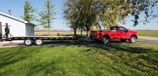

With enough heavy duty ratchet straps, it shouldn't blow off.
Riggerson
Dec 8, 2018
44
Atlanta
Build a skid out of 2x4's and 4x4's sized for the mill and a pallet jack. Have your employer place the mill on the skid with a fork lift. Now you can move the machine around easily and safely with a pallet jack. Rent a drop deck trailer from sunbelt (the type they use to move scissor lifts). Also be sure to bring plenty of the large 10,000lb ratchet straps.
