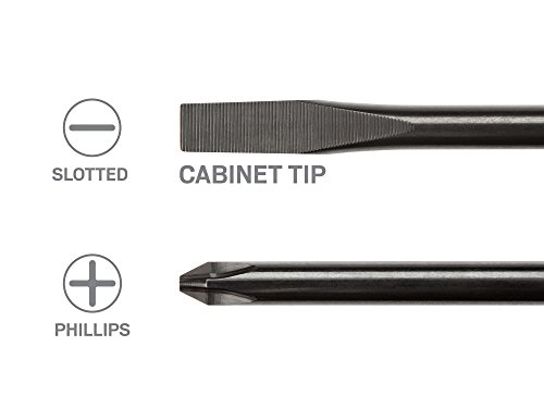

Cant wait for the "Whats the difference between a phillips and slotted screwdriver?" thread

What about reed and prince? Looks similar to Phillips head.
But has a sharper point and different geometry. I remember being told Reed and Prince = real pointy
