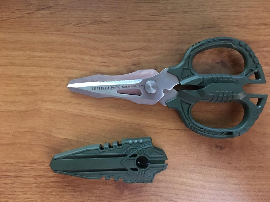

You guys see these?
Made by Engineer, who makes the Neiji-saurus pliers (also rebadged as Vampliers).
Just picked up a pair from eBay, shipped from Japan, showed up late last week.

I have a set of those along with a similar set of Betas. They are great for cutting sandpaper, scotch-brite pads--anything abrasive. Both have proven tough. I also have a set of older Victorinox scissors that came with a knife. Very sharp and great on gasket material.
My other scissors are strictly for paper or fabric. I'll have to post some pics as most of them are ready for restoration to begin.
