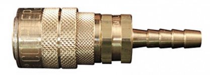

Schrader valve is it’s own unique thread, .305-32. Taps and dies can be purchased on eBay and you can make anything you want.
I use a Milton 731. It is the standard male ‘M’ air fitting on one side, and the female is for the tire valve (.305-32) NOT 1/4 NPT. You remove the valve, then screw this on the stem, then connect your air hose. I seat my beads with this, but am careful to remove the air fitting once the bead seats so as to not over pressure the tire and explode it.

I took the hoses off an old cats eye inflation setup. theyre braided stainless steel with the female end to fit the valve stem and the other end is 1/8npt so all you have to do is put a regulator on the 1/8pipe end and stick it on and forget it. I also do alot of trailer tires, and it really wastes time standing there holding the hose watching the tire fill up.

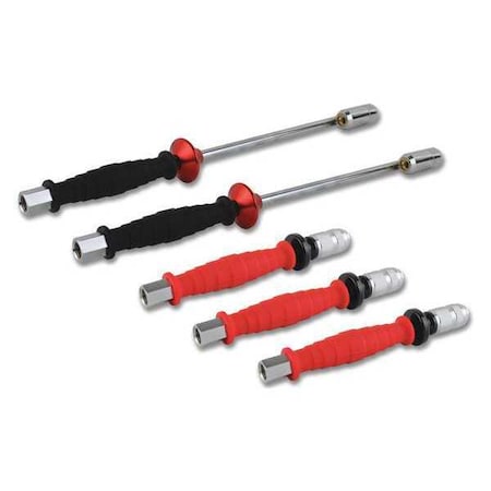

...I currently have the clip on adapters, but they don't hold the stem ...
That's because you're using the **** clip ons.
I have one of the short red handled ones of these:
https://www.zoro.com/innovative-pro...chuck-kit-15-12-l-x-7-34-w-9060m5/i/G6152091/
You push it onto the schrader, and it grabs from three points and will NOT release or leak. Then pull on the collar and it falls off. It's actually from this setup:
https://ipatools.com/products/9060c-5-tire-pressure-equalizer-system-with-chucks.html
Mac tools sells a rebranded version of this:
https://www.mactools.com/en-us/Brak...c91-4b87-85af-a585012f6581/Lock-On-Tire-Chuck
The Mac version is "closed", so it works great on the end of an air line, but not on an inflater/deflater.

What you want is a "screw on tire chuck to hose barb adapter". If you google those word you will see a few. Just slip on and clamp the right size hose and you are good to go. No need to cut up another hose to get the fitting though that might be the easiest way.
