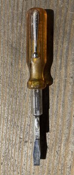

Posted this on another thread: https://www.garagejournal.com/forum/threads/lets-show-our-wood-screwdrivers.458966/post-10993110
Found this in a lot of vintage tools from an estate sale. I can't find any identifying manufacturer marks on it.
The only writing I can see is "Grip Point Patd" (at least I think that's what it says).
I assume it's some kind of screw-holding screwdriver. When I push up on the knurl/knob there is a shaft that slides up into the notch (see the two photos with the tip).
I went back and read the previous posts here and I don't see one like this.
Any ideas on manufacturer/make/model?

This is a Grip Point Pat’d marked tool, and the list puts it as made by
Stromberg / Stromberg Motoscope, 2703 Belmont, Chicago, IL / "Grip Point" screwdriver /
You can find "the list" (US Mfgrs, A-Z) that RTM is referring to in the Sticky, post #6.
You see the Search tool, upper right, right? You can select Everywhere, This Forum, or This Thread. Advanced is helpful, too.
29,545
Humbolt Iowa tool auction says Goodell Bros. :dunno:
looks like this is where I found the "Stromberg" connection, which appears to be in error....
Stromberg DID make a "Grip Point" screwdriver, but it appears to be a different "Grip Point" than @gordyzx9r 's specimen. :dunno:
The second image (1937 "Service" pp 438) describes how the device is employed by the "release of a lever", a feature not found on @gordyzx9r 's unit.
Still lacking a patent number on the Goodell unit, which may possibly make a change in the "timeline of evolution of screw starters".
I have yet to see a marking on the unit or a trade mag etc demonstrating that it's Goodell Brothers, and I can't find a record of a patent to either brother for a screw starter/holder on DATAMP or anywhere else, or any record of Goodell Brothers TM'ing "GRIP POINT", but if it is, that would mean pre-Pratt (1898), and it would, indeed, be older than the Campbell (1902) by at least four (4) years.
The oldest Goodell-Pratt catalog on IA/ITCL is 1904. No "GRIP POINT" or any other screw starter inside it. I guess it's possible it didn't make it from the Goodell Brothers line into the early Goodell-Pratt line, but I find that a little odd.
29,545
^ Currently the only the information available is that above from the Humboldt Iowa Antique Tool Auction from May 2012, until such time as something turns up in a contemporary trade journal.
30,821
I saw it. How did they identify though? It's an empty reference. A reference without a reference. As you know, there was a time when nobody in this hobby would think to question anything with the dint of authority like a tool auction. Unfortunately, we've seen many mistakes that thrive in perpetuity. It's vexing that the information doesn't show up in all the usual places. That can mean it's just hard to find. Not a patent assigned to the Goodell Brothers, for example, but one they used under license. But even that's not mentioned anywhere else. I'm not challenging the Humboltd IA auction log. But this clearly needs a reference.
The Stromberg GRIP POINT works exactly the same way, by the way. It is actuated differently on the shank. But on the business end the little dynamic cruciform piece turns inside the flathead blade exactly the same way. Stromberg may have simply copied it - and the name, of course, in the 30's. There is also a Vaco GRIP POINT in the 60's. I have not seen an example, but my hunch would be it's also a knock-off.

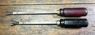

Back in August 2022 I found a c. 1925 Seth J. Cox patented "HOLDFAST" screwdriver, made in Franklin, PA, at one of my flea markets. It was only marked 'PATENTED'. That post, with the patent diagram, 1929 Popular Mechanics ads, and a DATAMP page link, can be found upthread here.
Yesterday I found another one at the flea market and it shows some evolution. This example, with a shorter shaft, is marked with the patent number (1562543), for one. I'm guessing it's older and they dispensed with the number later. They also changed handle style (6-sided to round with grooves) and finish (black to cherry). These are handsome screwdrivers and I am very pleased to have found them both.

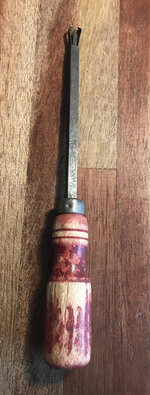

Here is one I found at an estate sale last week. It’s an Upson Bros Hold-E-Zee but the handle markings are unusual. “Sell Servel Supermetic” with a pocket clip as well.

FWIW: another example of Cox's screw starter (patent 1562543) has a much shorter handle than the two examples you've already posted here:

... after I posted those images (from a Dec 2023 ebay listing) the question occurred: is it possible that unit was cut down by a previous owner, or was there some design change, or were there possibly different models? (wild speculative thinking of course.)
30,821
All feasible possibilities on the shank length. If you look, my two examples, different in production era (PAT PEND, and patent number), don't have quite the same shank length, either. But by "stubby" I was referring fo the handle. It's very short. Looks roughly half the length of mine.
Yes. I saw both of yours, and then looked in my "Cox" folder and found that ebay example, which is quite different.
Hence my speculation about "different models".
The ebay specimen on the RED background is 6 inches overall length.
Another example found on ebay is 8.5 inches overall length. And yet another example found on ebay is 9.5 inches overall length.
:headscrat
The handle on the "stubby" looks kinda-sorta "factory" to me. :dunno:
The seller of the red-handled unit says 8.5 inches overall length, but didn't provide a photo next to a ruler.
The black-handled unit is clearly 9.5 inches. That handle looks kind of "plastic-y", no? :dunno:
