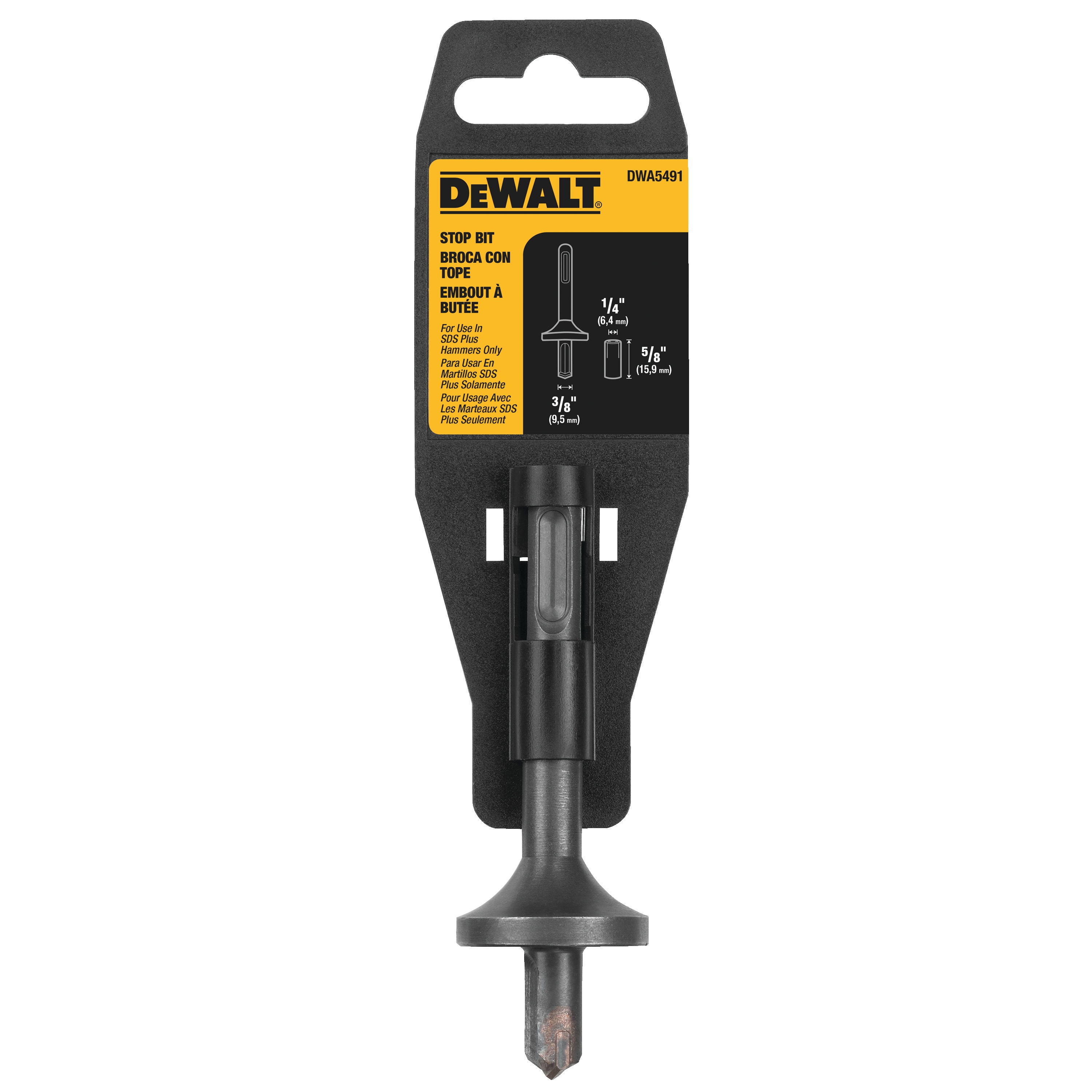

What about cutting off the drill portion of a stop bit?
https://www.boschtools.com/us/en/boschtools-ocs/sds-plus-stop-bits-hcstp2084-35295-p/
This DeWalt bit claims to have an oversized 1-1/4 shoulder, which would make a nice hammer face:
