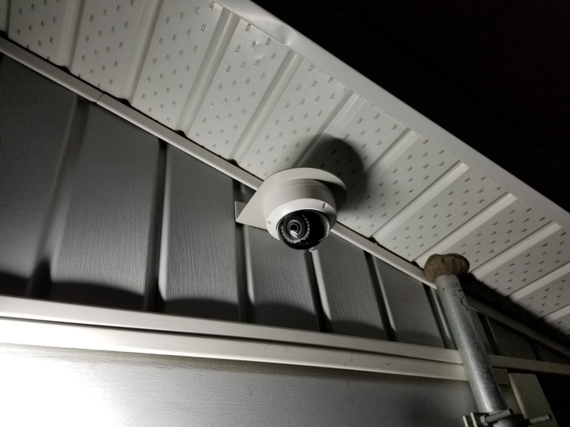

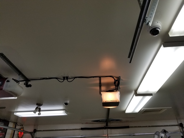

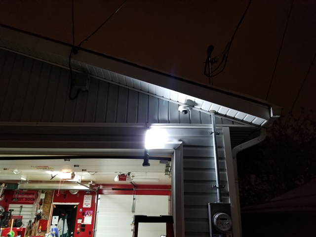

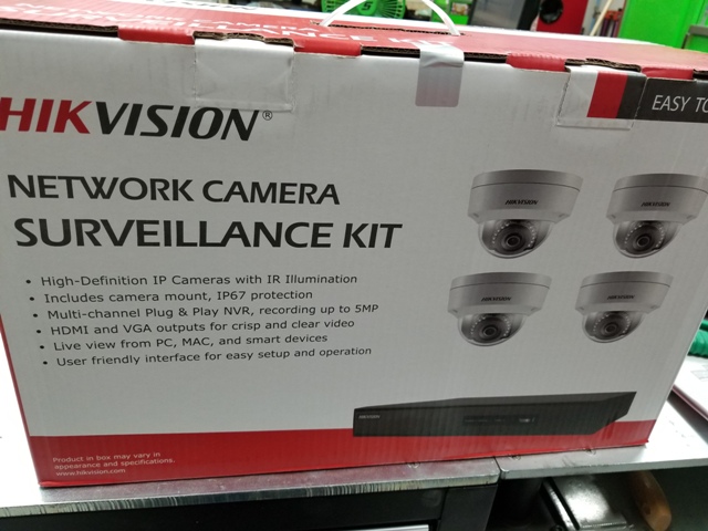

I am installing a HIK Vision 4 camera system in the garage...
Two facing each door from the inside, and two facing each way down the driveway and alley...
I didn't want to hang them on the angled soffit, so I made the brackets to mount them on the wall...
I ran Cat6 cable and am going with poe... I still need to get a 25 foot hdmi cable so I can put a monitor for them on my tool box... Then get my IT buddy over to set it all up and get them recording!!
