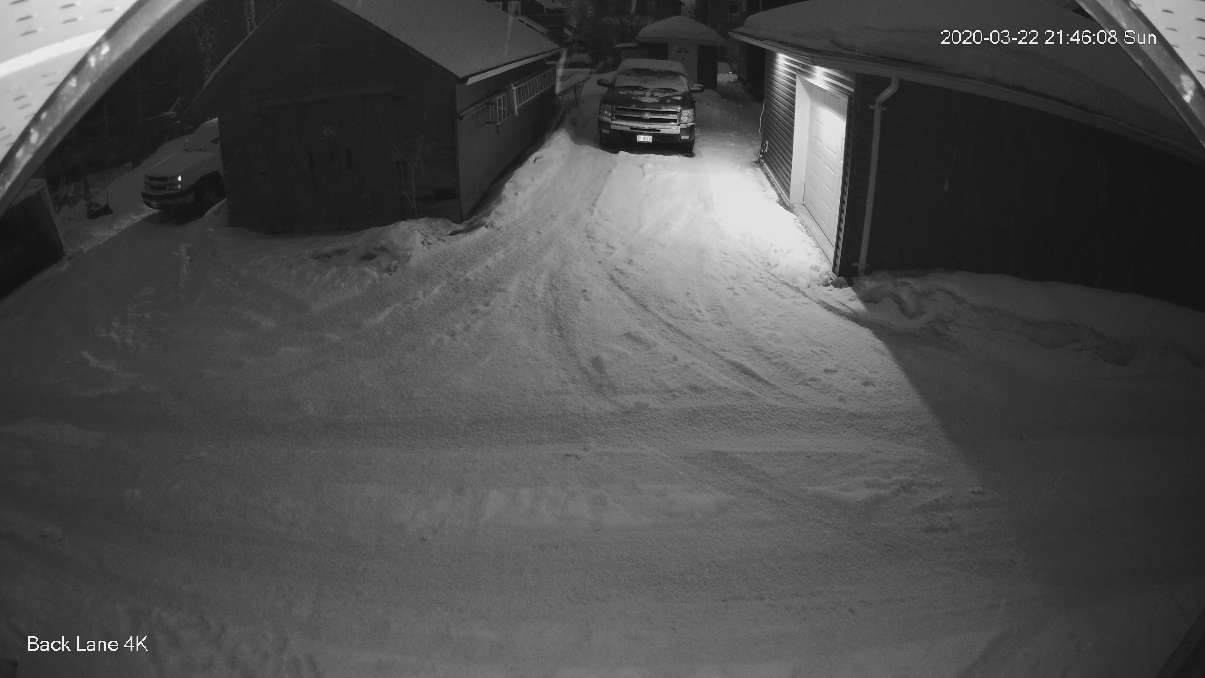

I picked up a few of the Amcrest IP8M-2496E 4K Cams. Lens option is 2.8mm. They also sell this with a 4mm lens: IP8M-2496EB-40MM
$109 USD.
Camera is 4K, POE, with SD card/FTP/NAS/Cloud recording. Metal case, nice build. The camera is fairly compact..about 8 inches long including the mount. The camera setup has a lot of options, but very similar to the the older 1080 PTZ cams...I have a few of those as well. Below is an uncompressed .png file (about 5MB) at night from the camera facing our back lane. Truck is about 40ft away:
Click on the pic to enlarge it.
Viewing from the iOS app with the HD option on, you can zoom in easily and read that plate. I was able to play back motion events remotely from the SD card at full resolution as well (3840x2160 resolution @ 10240Kbps)

Arlo won't work below -5F...so not suitable for our setup. I've also found a lot of issues recording higher bit rate video over WIFI, so don't do this anymore. Wired POE and 4K is the only way to go..as far as reliability/usability goes. I do have a few of the PTZ 1080P cams and they are fine for smaller areas and close range.
I looked at a daylight screen grab from the 4K camera. The .png file is 9MB vs 5MB at night. There's a lot of detail there!
