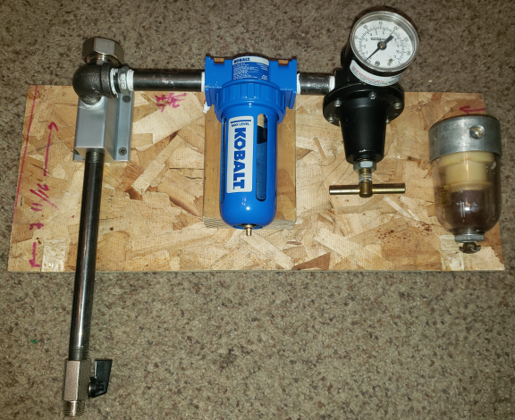

I'm running my compressor lines and I think I want/need to replace my air regulator(s) and water traps.
I used 3/4" black iron and a stainless 3/4" flex pipe from the compressor and for the first 6 feet with a down leg to collect water, and then it switches to 3/4" Maxline. The outlets at the end of each line reduce to 1/2". My older filters and regulators are 3/8" and 1/4". (Both regulators are 3/8".) My air hoses are 3/8". I am thinking that I want to dump AT LEAST the 1/4" filter, and possible upgrade the regulators to 1/2", although I am unsure that this is necessary since my air hoses are 3/8."
The first regulator is a 30 year old Stanley Bostich, and the second is a cheapo Kobalt. I Just replaced the Kobalt under warranty because it leaked constantly, so I can return the unopened product if I want.
The compressor is a 60 gallon 230V 2-stage Kobalt that's made by Campbell Hausfeld, which I picked up on sale. I will be using it primarily for my air tool (impacts, ratchets, drills, cutoff, grinder/sander, etc.) I might use it occasionally for my modified Harbor Freight 20 gallon sandblaster and eventually some small motorcycle painting products, but I will add a dessicant before I start painting. I understand that the compressor is not ideal for high CFM work like sandblasting, but for the occasional use I plan, I will make do.
I am retired, and the work I will be doing is as a hobbyist, so I do not need something designed for professional use, but I am a firm believer that "the bitterness of low quality remains long after the sweetness of low price is forgotten." Therefore, I am looking for your suggestions.

This is what I have at the moment. The Kobalt filter is supposed to filter down to 5 μm, and the Monnier (on the right) can filter to 3 μm, but has 1/4" fittings. I still have to finish running the air lines, but I have to go get some insulation first so I don't keep ******* through propane so fast trying to keep warm out there!
The nice thing about retirement is that if I don't get it done today, I can work on it tomorrow! :D
