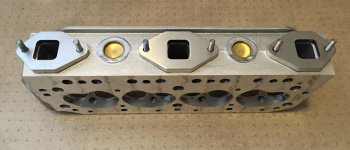

Sent drawings on Monday, laser-cut, 3/8" plate 304 stainless steel header flanges on my doorstep by Friday. :cool:

I'm not knocking them but I did their quote and they gave me an estimate for 950ish for 12g 304 for a work envelope of about 2'x3' while oshcut game me 340 for the same piece. The local shop quoted it in at 10 bucks cheaper than osh. I don't know if it was a glitch in their system but that quote wasn't even close to reasonable.

They charged $100 for the 6 header flanges, 1-day shipping included. So about $17 each.
